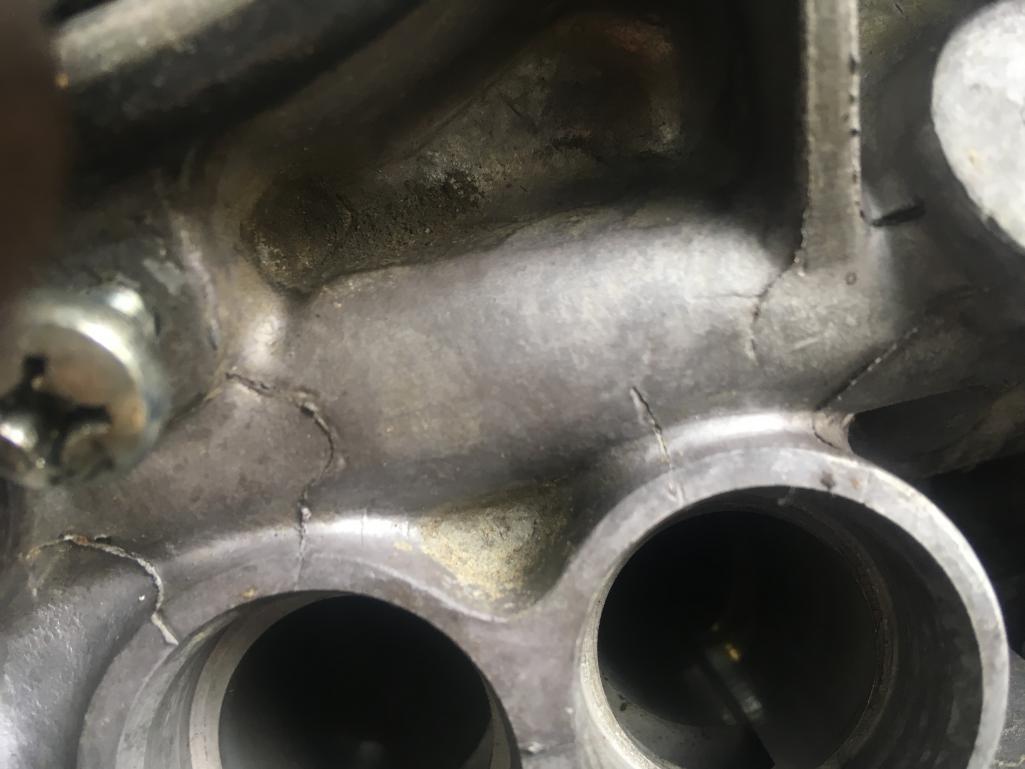

Hello,
Heads, pistons and cylinders are at the machinist shop.
Now the long block is fully cleaned and I discovered severals scraches than are crossing the engine.
Some pics

CheeRS   Hello, Heads, pistons and cylinders are at the mac...   May 28 2019, 09:53 AM
CheeRS   more   May 28 2019, 09:54 AM
CheeRS   Is the block dead ?   May 28 2019, 09:55 AM
CheeRS   last one   May 28 2019, 09:56 AM
CheeRS   with nail we feel an angle so the block has moved   May 28 2019, 09:57 AM
Dave_Darling   We would call those "cracks", not ...   May 28 2019, 11:40 AM
sixnotfour   out side of case,,get a die kit,,,casting flaws ??   May 28 2019, 12:09 PM
ChrisFoley   I see casting lines, not cracks.   May 28 2019, 06:37 PM
Jetsetsurfshop   I see casting lines, not cracks. Same. Casting...   May 28 2019, 07:40 PM
Dave_Darling   Well, if Chris says they're not cracks, believ...   May 28 2019, 08:53 PM
sixnotfour   I Pointed to a true solution ...not an opinion..   May 28 2019, 08:54 PM
Bleyseng   I Pointed to a true solution ...not an opinion.. ...   May 28 2019, 09:09 PM
McMark   :agree: Casting marks. Nothing more.   May 29 2019, 01:12 PM
