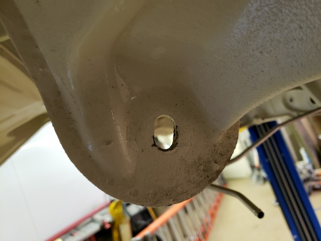

Almost immediately, after looking the car over, Glen ID'd an issue which neither I nor my body man noticed......Attached Image

Targa70   Almost immediately, after looking the car over, Gl...   May 29 2019, 06:28 PM
dr914@autoatlanta.com   isn't the slot in the rear suspension console ...   Jun 21 2019, 09:00 AM
gms   isn't the slot in the rear suspension console...   Jun 22 2019, 02:40 PM
Targa70   And he promptly repaired it.....   May 29 2019, 06:29 PM
worn   And he promptly repaired it..... You guys really...   May 29 2019, 07:31 PM
