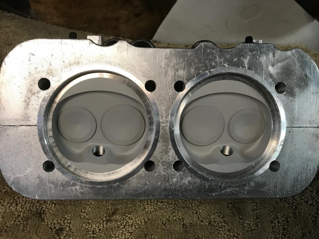

Buy a set of these with the coating to keep the heat out of the head.

QUOTE(Bleyseng @ May 11 2019, 08:57 AM) *
This is a picture of the coating on the heads including the exhaust ports. Len has said it saves a many a race engine as the heat flows out of the heads instead of into the aluminum.

Bleyseng   Buy a set of these with the coating to keep the he...   May 11 2019, 09:57 AM
CheeRS   Buy a set of these with the coating to keep the h...   May 11 2019, 06:38 PM
Bleyseng   Buy a set of these with the coating to keep the h...   Jun 1 2019, 10:38 AM

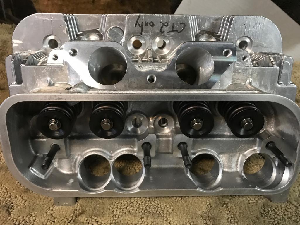

CheeRS   hello, heads came back from the shop, new seat, he...   Jul 5 2019, 03:19 PM

CheeRS   Lastly, I wanted to install 911 elephant feet but ...   Jul 5 2019, 03:24 PM
Bleyseng   You must grind off some of the rocker arm (while n...   Jul 5 2019, 05:40 PM
