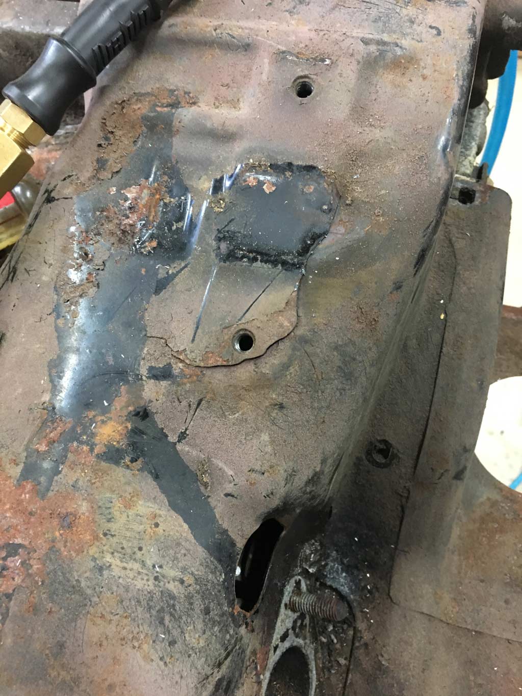

After finally getting down to the bare tin, I was a little bummed to find the passenger side tin is cracked. Not a big deal but like everything else . . . something else that needs fixin'.
Since the cheesehead screws had never been disturbed quite a few were really rusted. Penetrating oil did the trick on most. But there is always that one. You know the one.
(IMG:style_emoticons/default/ar15.gif) The one that won't break free. Heat. Nope. Impact driver. Nope. Weld nut broke free? Nope. Finally it just pushed though the tin from hammering on it with the impact driver. Not the end of the world. Just another little hole to be welded up and re-drilled.

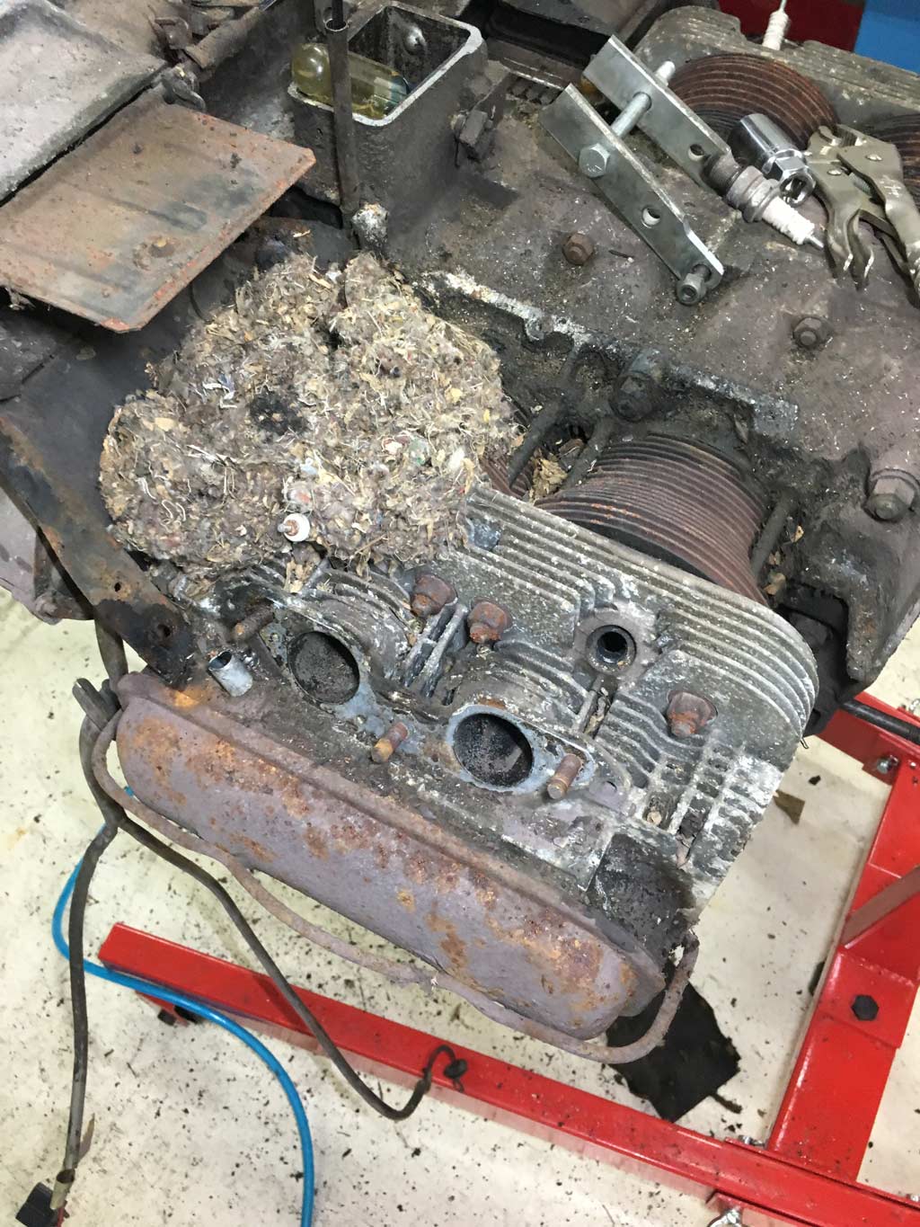

With that out of the way I pulled the tin. Crap. Mice have been here! (IMG:style_emoticons/default/wacko.gif)
On the other side, I found all sorts of goodies. Old spark plug extension between the cylinders and basically just a bunch of blocked fins from leaves and the mouse house.

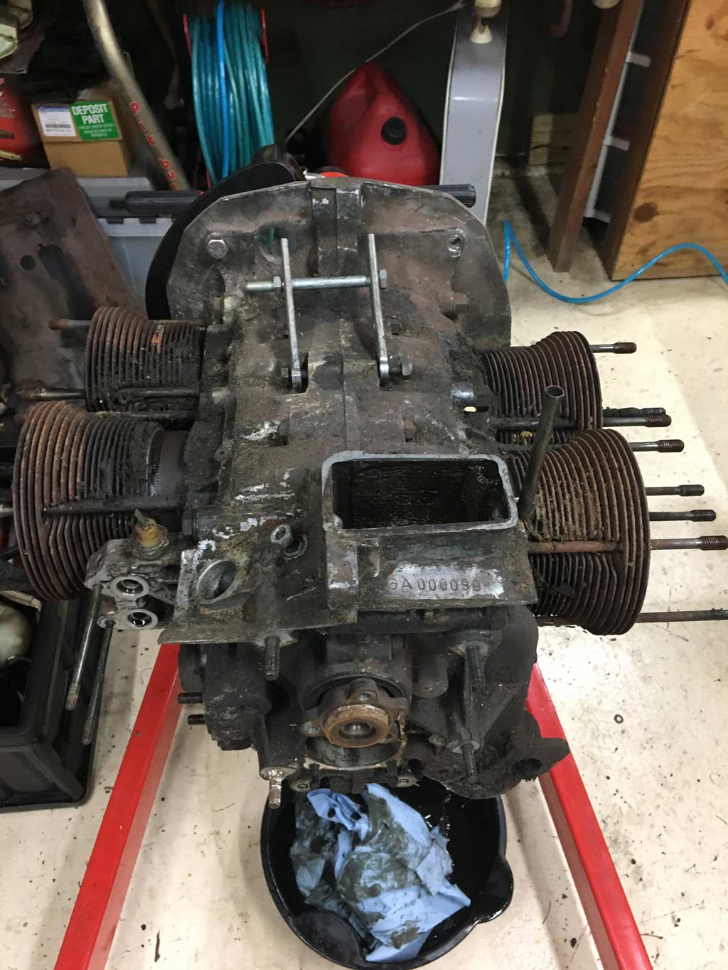

Pulled the cylinder heads which basically look pretty decent but will need to be cleaned to see if they have cracking.
And with that -- Ta da! Stock pistons. Sweet.
Just what I had hoped to see. Time for a drink (IMG:style_emoticons/default/beer3.gif)
I think I've had five of these engines now and don't think I've owned one that wasn't cracked in that area. The vibration of the coil mounted there is the issue. On my current build, I left the repair weld unground on the inside thinking it will help reinforce that area. I think they moved the coil onto the fan housing in later years but am not sure. Regardless, the mount cradle is there if you don't want a repeat, but I'll have to give you (IMG:style_emoticons/default/stromberg.gif) crap about relocating your coil on your pure stock engine. (IMG:style_emoticons/default/lol-2.gif)

QUOTE(bbrock @ Jun 4 2019, 08:47 PM) *
QUOTE(Superhawk996 @ Jun 4 2019, 06:20 PM) *
Looking forward to watching this come together!
Yes, mount your coil here where God intended. Folks will have the correct bracket for you
