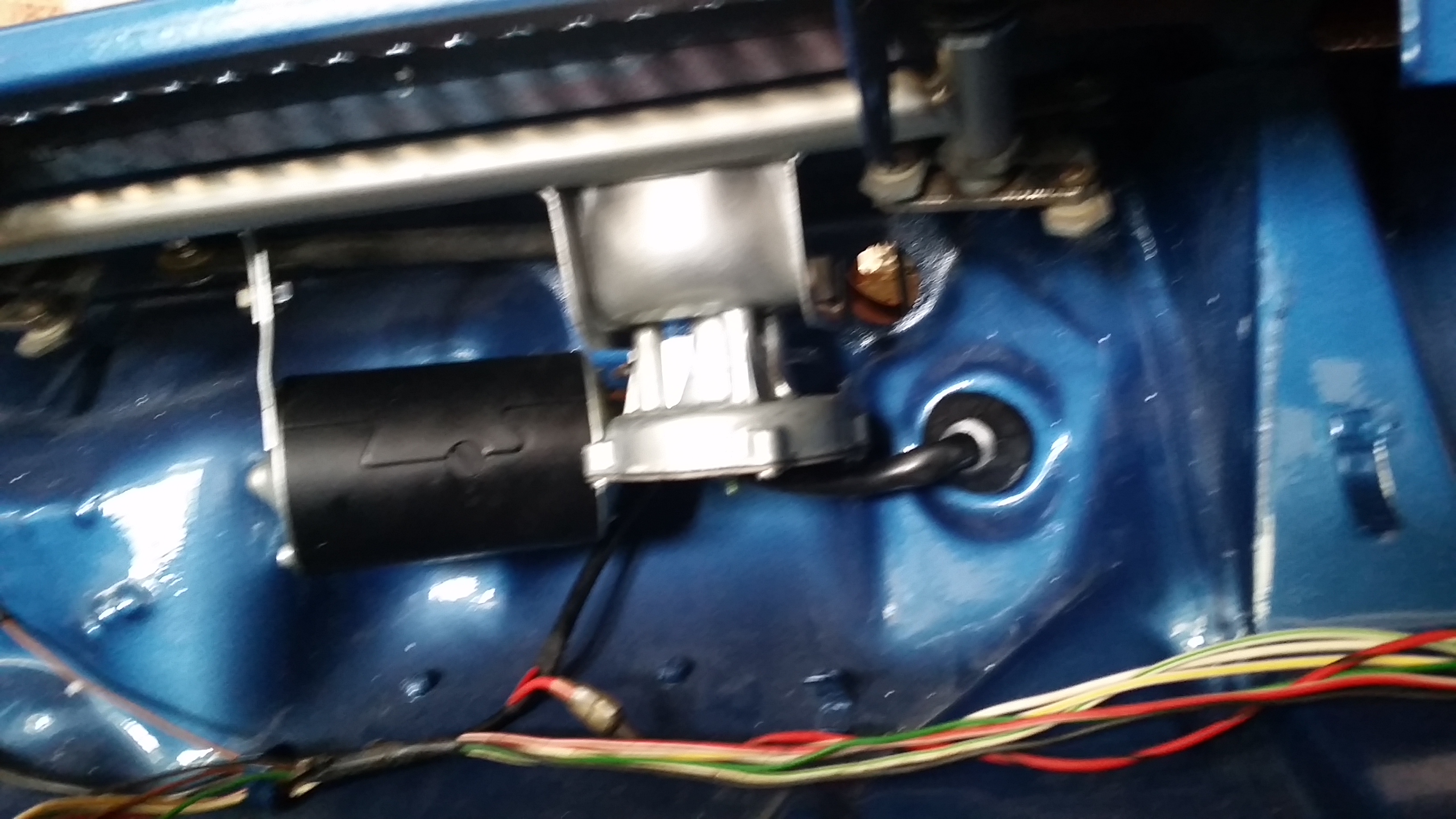

True, and if you are lucky enough to find one, it won't be cheap. A$k me how I know (IMG:style_emoticons/default/beer.gif) Attached Image
