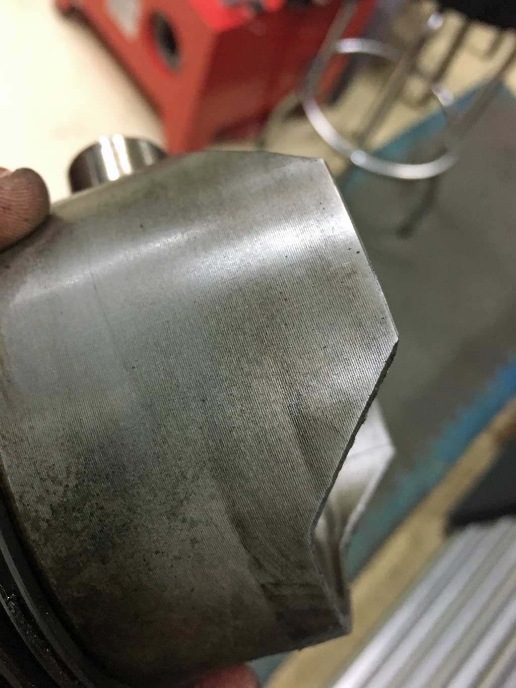

Last night I began pulling pistons and cylinders.
Looking to be a low mileage engine.
Piston skirts have virtually no wear. You can still see all the machine marks from when the pistons were originally machined. (IMG:style_emoticons/default/biggrin.gif)
The wrist pins are also pretty tight. Usually these slide right in and out on a well worn engine. These are a firm slip fit and take a little bit of persuasion. Not excessive but tight as if there aren't many miles on them.
Looking very likely that the pistons will only need a new set of rings. Measurement of piston ring groove clearance gaps will be the final judge.
Should have the case split later today. (IMG:style_emoticons/default/biggrin.gif)
