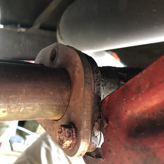

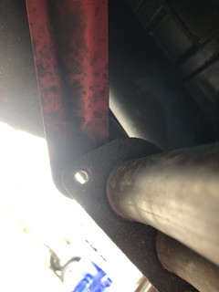

Well, my theory was somewhat dashed yesterday afternoon, but also somewhat supported.
In the ECU, the AFR EGO was set to adjust fuel only under kPa 0 - it was turned off. I set it to activate under kPa 85 which means it will be active everywhere (after warmup) except WOT.
However. Two missing bolts... One on each side. When the hell did this happen?
(IMG:http://www.914world.com/bbs2/uploads_offsite/live.staticflickr.com-1435-1560863682.1.jpg)
(IMG:http://www.914world.com/bbs2/uploads_offsite/live.staticflickr.com-1435-1560863684.2.jpg)
So, before I go to texas next week I need to replace and test to see if there is an improvement.
