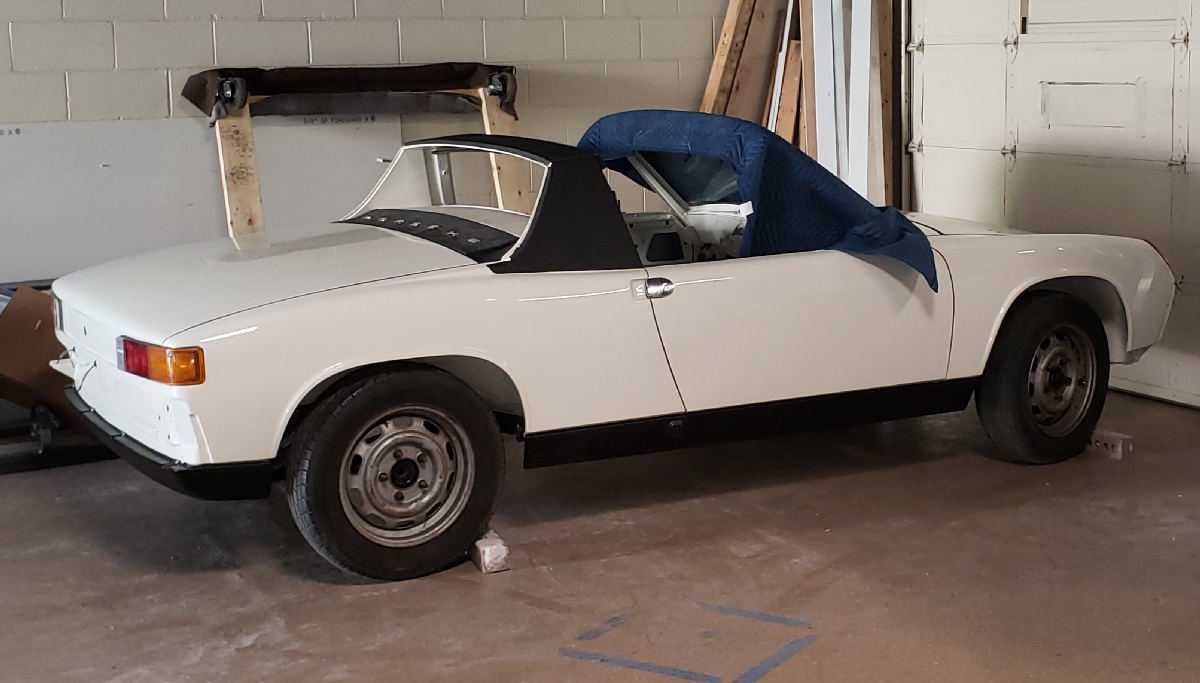

Targa70   It has been a few weeks since an update, but Glen ...   May 27 2019, 07:26 PM
Targa70   Here is the back end, and a snap of the targa moun...   May 27 2019, 07:34 PM
Targa70   I feel like when the sail trip vinyl goes on, it i...   May 27 2019, 07:47 PM
Cairo94507   Really changes the look of the car. In my little ...   May 28 2019, 07:01 AM

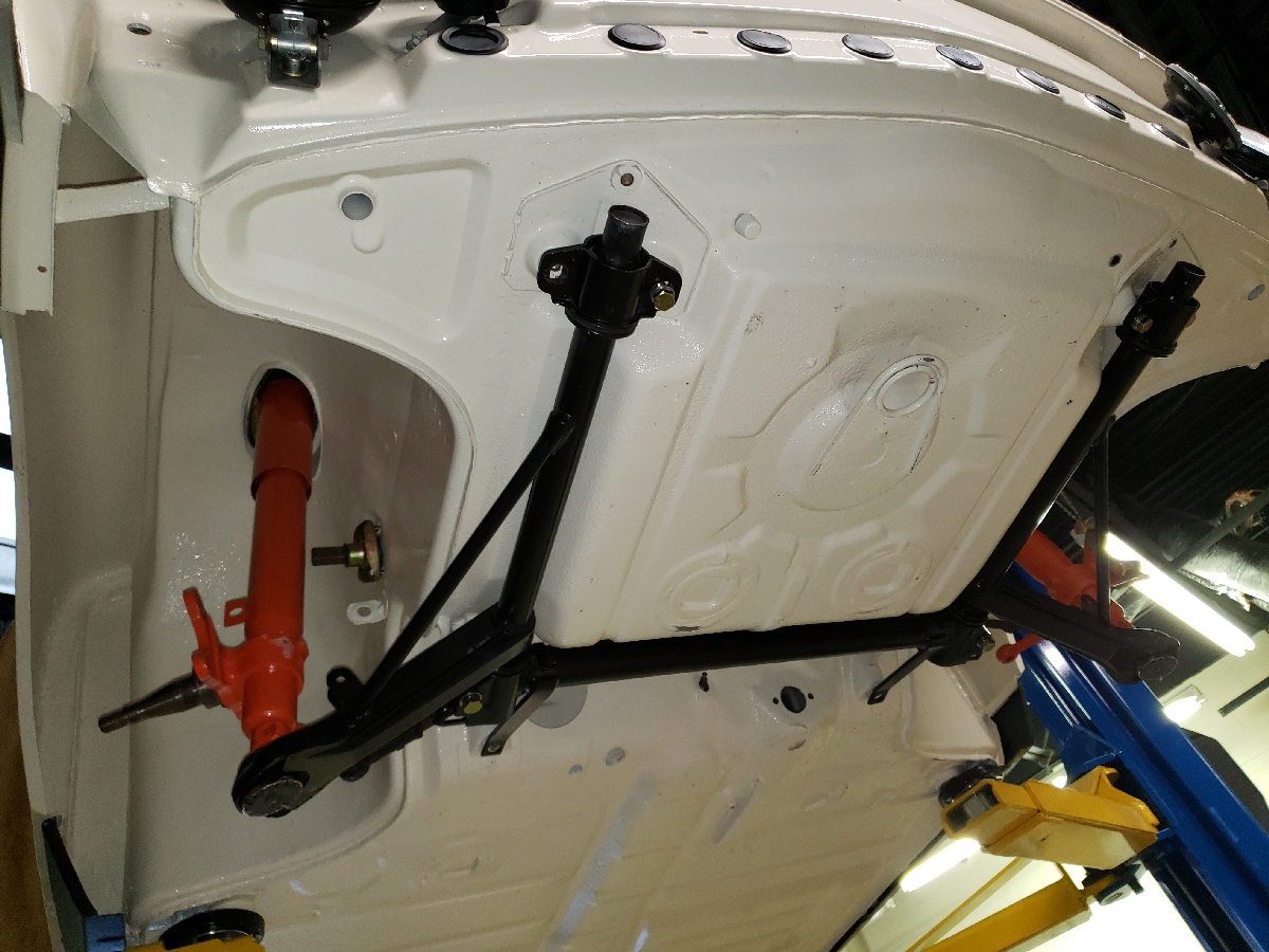

Targa70   Glenn sent me some progress pics of the rear suspe...   Jun 13 2019, 08:09 PM
Targa70   Swing arm with shock and rocker cover.   Jun 13 2019, 08:15 PM
Cairo94507   I like the underside with the body color- like the...   Jun 13 2019, 08:48 PM
rgalla9146   White with black is very beautiful :) A ve...   Jun 13 2019, 09:22 PM

gms   replaced the A-Arm bushings today.   Jun 16 2019, 10:21 AM
SirAndy   replaced the A-Arm bushings today. I take it you...   Jun 16 2019, 10:24 AM
gms   replaced the A-Arm bushings today. I take it yo...   Jun 16 2019, 10:24 AM
SirAndy   [quote name='SirAndy' post='2723118' date='Jun 16...   Jun 16 2019, 10:25 AM
gms   [quote name='SirAndy' post='2723118' date='Jun 1...   Jun 16 2019, 10:26 AM
gms   :smash:   Jun 16 2019, 10:22 AM
gms   Success!   Jun 16 2019, 10:23 AM
gms   suspension is installed, I set here back on the gr...   Jun 19 2019, 07:21 PM
