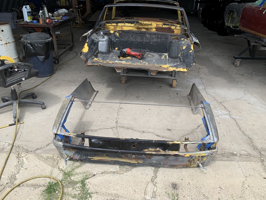

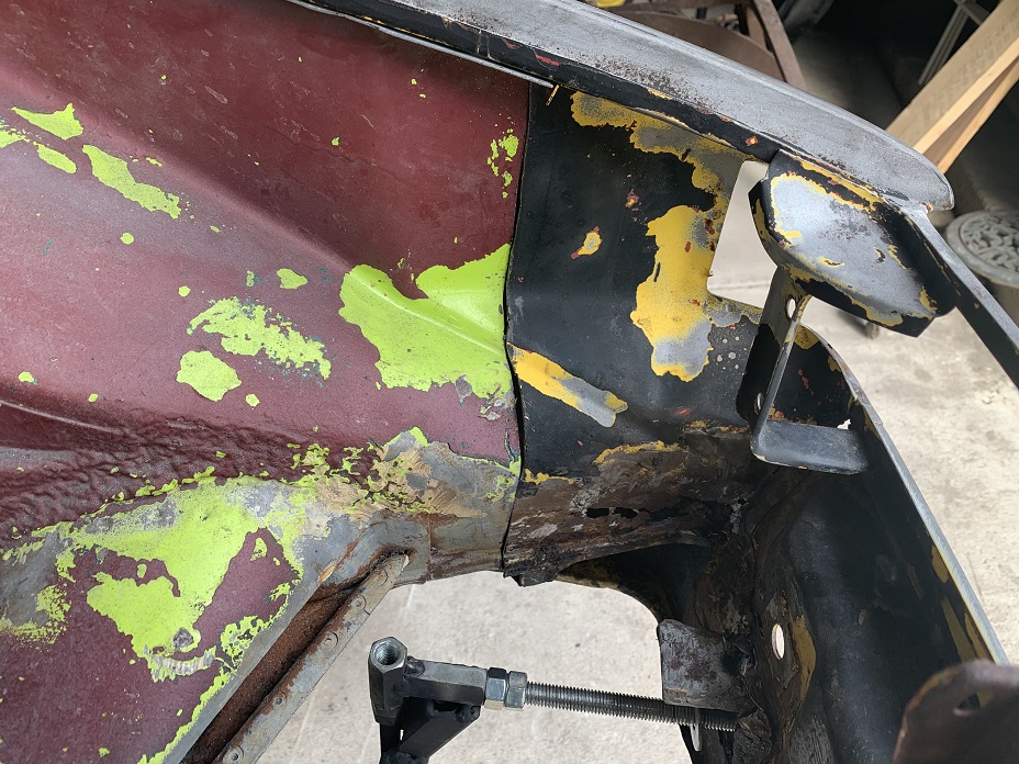

I spent the weekend at the farm and finally had a chance to cut the portions of the quarters and tail section from the parts car and do an initial fit onto my car. Here is the parts car before cutting the quarters:
And after removal:

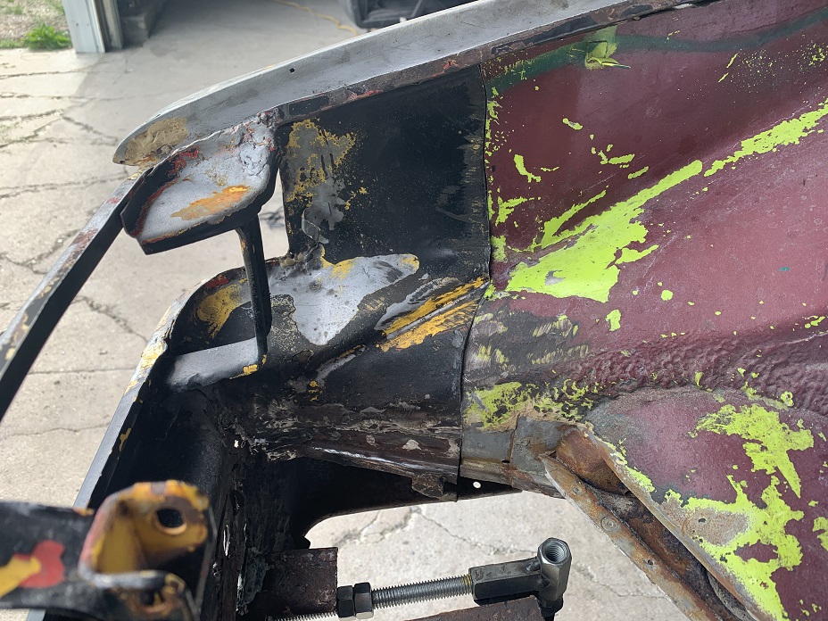

It will take A LOT of work to make these pieces acceptable, including making new where they mate to the door jam, but the end result will be far better than what I had to begin with.

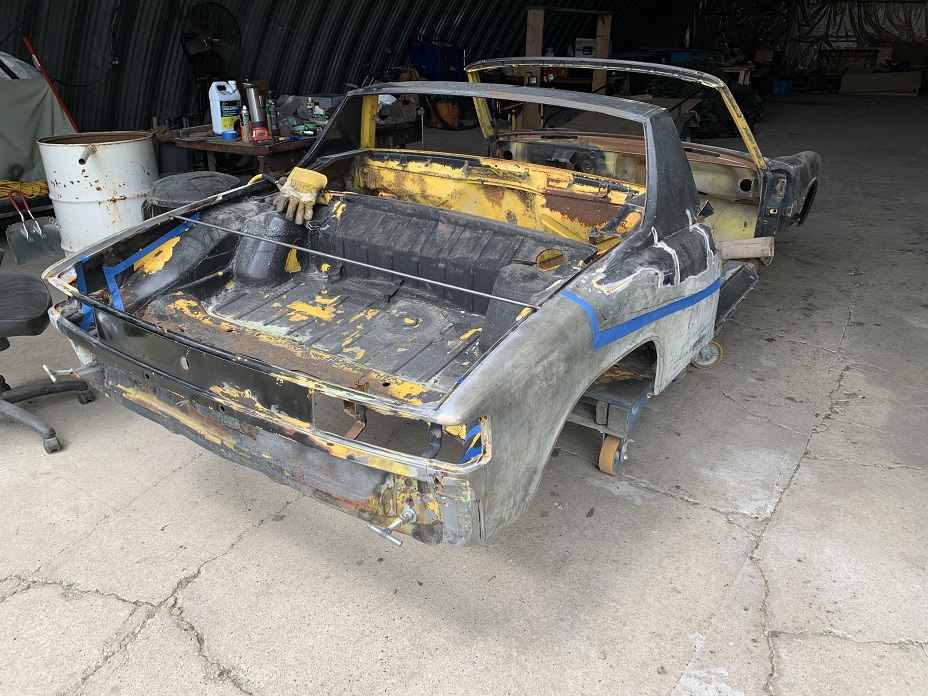

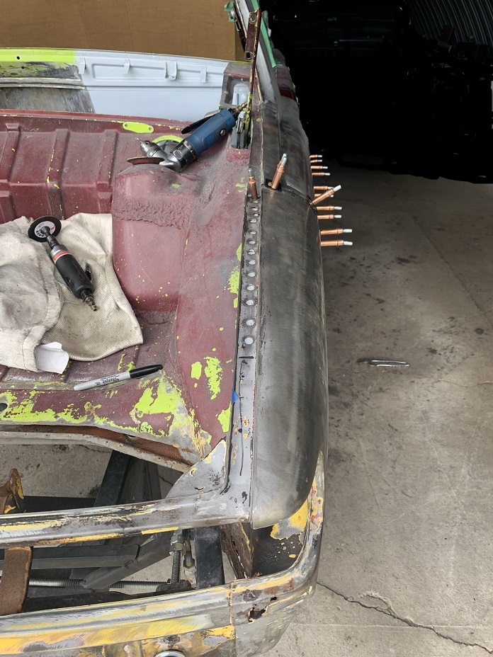

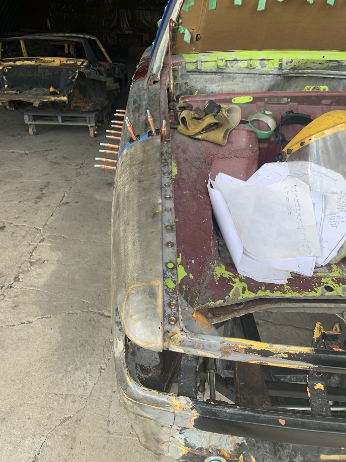

I'm also going to need to tweak the fitment, but not bad for simply 'cutting and pasting' (after a lot of measuring back and forth):

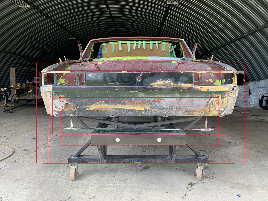

And, it appears to me that the straightening, on which I reported earlier in this thread, was effective since the tail section appears to be pretty straight! Here is the update pic.
There is a lot of work to do before I'll be able to weld these parts to the car, but I'm relieved that it looks like I'll be able to make them work.
