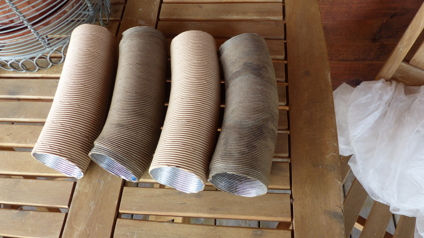

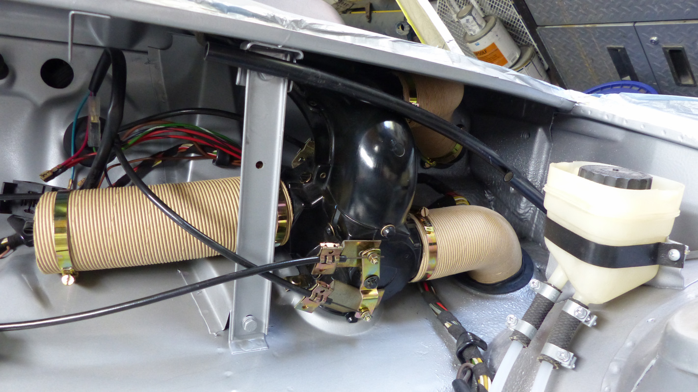

One last post to finish this out. I decided to swap out the 60mm hoses for the URO ones. The 914Rubber hoses are way more durable than the original or repro paper/foil hoses, and they are easier to install. I've discovered I have a bit more "weanie" in me than I thought though so wanted the original look.
As with the 50mm hose, this 60mm hose is a nice reproduction of the original. Here is the new hose next to some of my stained and dirty originals.
Unfortunately, I screwed up my measuring and ordered too short of a hose for all four pieces needed. That was an expensive mistake as it's going to cost me about $20 extra over what the right length hose would have cost. (IMG:style_emoticons/default/headbang.gif) It you decide to do this, you want the longest (1500mm) posted by @UROpartsman a few posts above. Screw-up aside, I think what I've been able to install dresses out the bulkhead area nicely.
