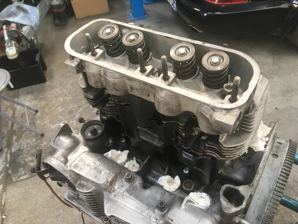

two weeks ago I was in Monthlery near Paris France, for a wagenfest with my 914.
Get some troubles with the engine, a hammer noise and the engine stopped smoothly like out of gas.
here is what I found :

in the moment I started to go up but without doing a cylinder height check

914_teener   classic dropped valve seat. Pull the heads and re...   May 10 2019, 01:30 PM

GregAmy   I'd be more worried about the dropped valve se...   May 10 2019, 06:00 PM

Chi-town   Have the head checked for cracks before you waste ...   May 10 2019, 07:02 PM
Dave_Darling   After you look at the heads, consider the LN serie...   May 10 2019, 08:46 PM

Bleyseng   If I were you I'd order a set of new castings ...   May 11 2019, 08:43 AM

porschetub   I would be rather worried about rebuilding those h...   May 11 2019, 11:58 PM

CheeRS   hello, heads came back from the shop, new seat, he...   Jul 5 2019, 03:19 PM
CheeRS   in the moment I started to go up but without doing...   Jul 5 2019, 03:21 PM
