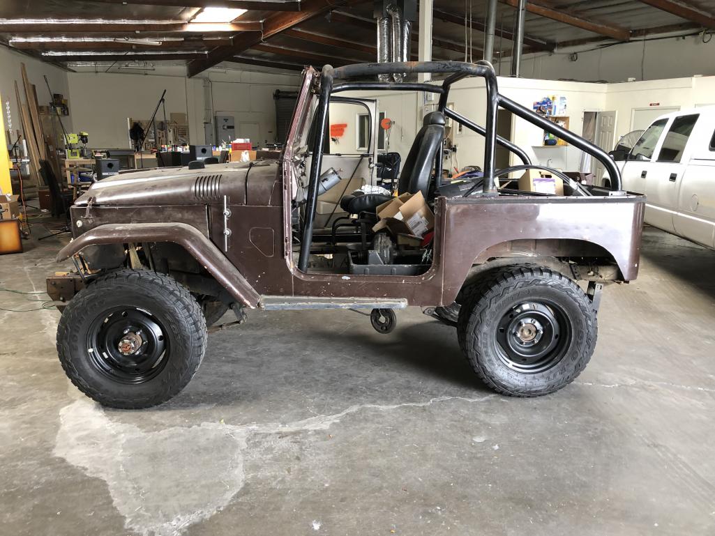

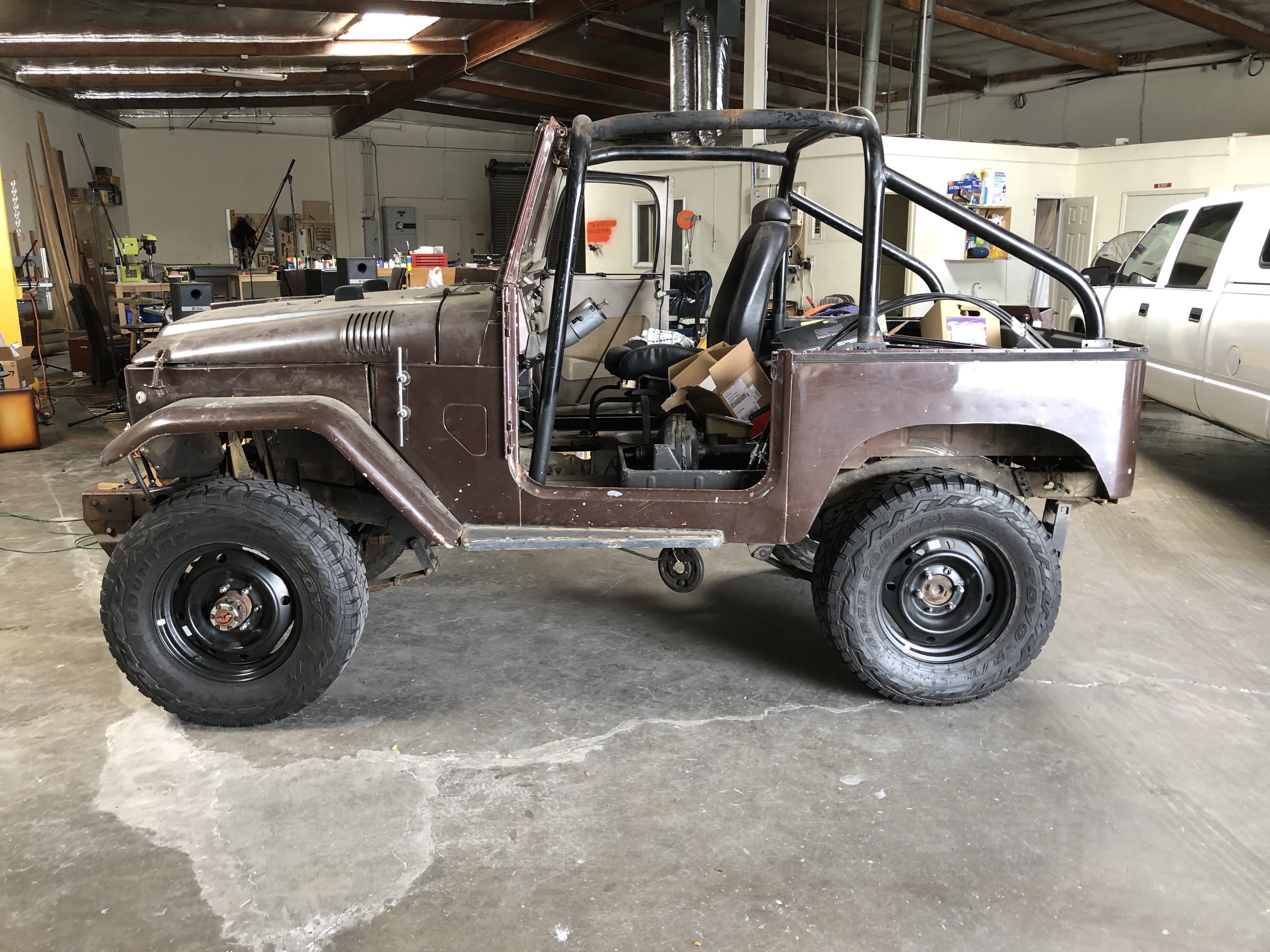

@Larmo63 , not over a cliff just deferred due to my buying a kind of silly number of other 914s. I also had to focus time/resources on two builds for charity events (Copper State 1000 Alfa GTV and pending Copper State Overland FJ40).
I picked up a muffler for the build this week and plan to coordinate with Ben in a couple months to make some more progress.
