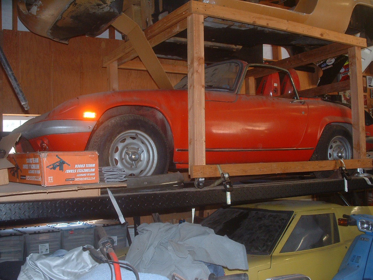

Oh, and I had my 2002Tii engine rebuild.
And bought a Lotus Elan project because, well, it is a Lotus Elan.Attached Image
