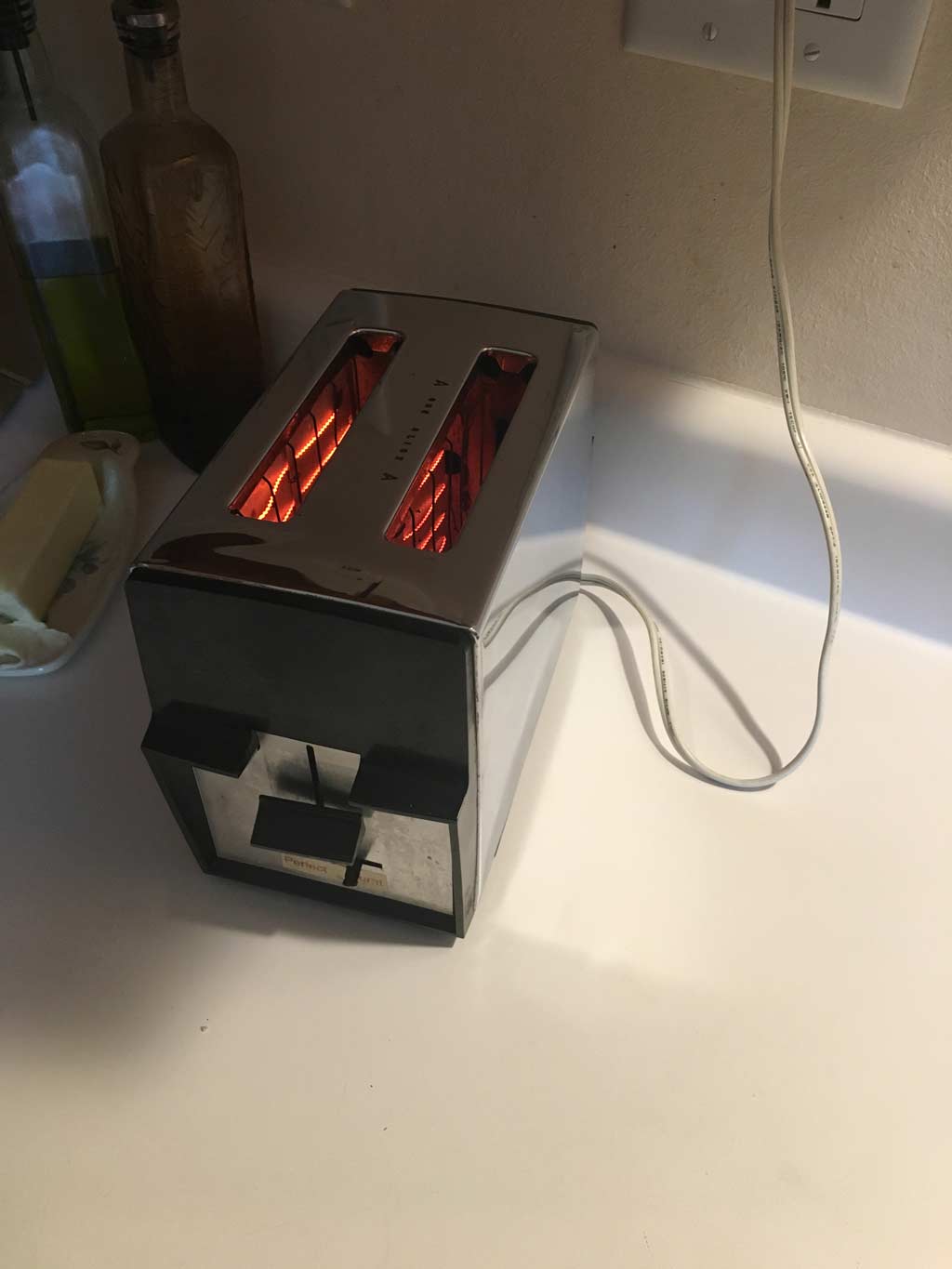

Today my beloved Vintage toaster took a dump. I've had this baby for over 27 years myself. I bought it for $5 at Goodwill when I was in college and too poor to afford a new toaster in my 1st apartment. I love vintage stuff because it WORKS and is easily serviced.
This is a toaster from the era before the Lawyers took over product development. This Mother get roaring hot. It has a chrome metal cover without any significant insulation.
It actually does it's job and cooks toast in about 1 minute. Imagine that. No microprocessor. No modes for cooking bagels or pastries. No heating elements that barely get warm. Just a good old toaster that actually works.
It you are dumb enough to touch it when its hot - you will get burned. If you are dumb enough to stick a knife or fork in there while it's powered up, you may get electrocuted. Just the way it should be!
Anyway it was time fix it and fend off any sly attempt by the wife to replace it with some modern piece of crap.
Just a simple repair to the cord and it was back in operation. Plus a little buffing of the chrome for good cosmetic measure.
Back in it's place of honor and ready to cook!
