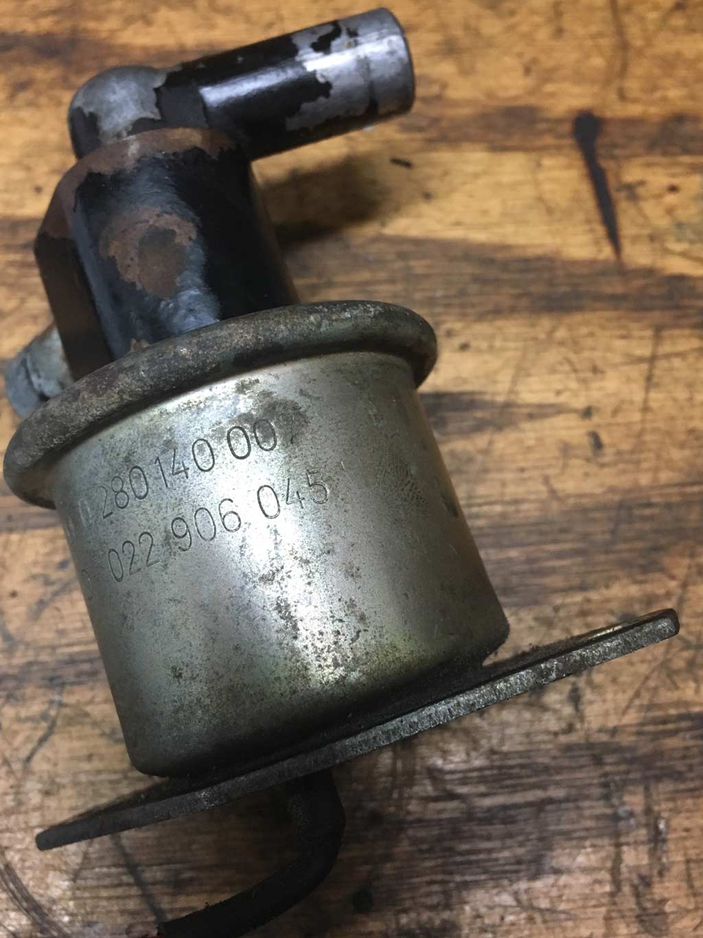

As an added bonus, this engine came complete with FI and as it turns out the Aux Air Regulator actually works. How cool is that!
Did a light cleaning and lube with some WD-40 and it is good to go!
