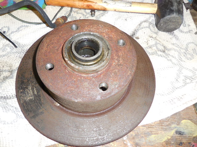

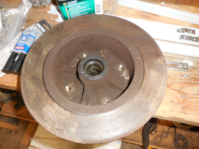

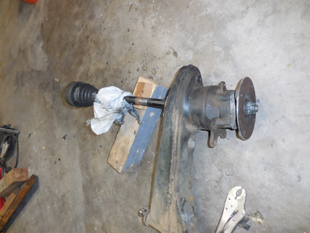

Questions for the 914 community.
1st my wife is laughing at me as it has been a year or so since i posted. Apparently no burglars wanted to break in, fix the porsche, and drive off in a sports car.... i even left the keys in the ignition, c'mon!
  1. How do i clean the rotors with the bearing in them?Attached ImageAttached Image
  2. How do I remove the transaxle from the rear trailing arm?Attached Image

brettrarnold   Questions for the 914 community. 1st my wife is...   Jul 17 2019, 09:22 PM
mepstein   Remove cotter pin from castle nut (nut inside of r...   Jul 17 2019, 09:33 PM

76-914   Drive the bearings and races out with a large sock...   Jul 19 2019, 08:01 AM
brettrarnold   Got the castle nut off using the impact gun!...   Jul 22 2019, 10:58 AM
