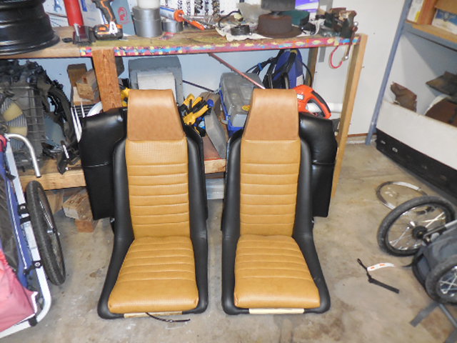

My seats got finished and i think they really came out nice. Dominick @ Monaco Auto Trim in Englewood CO was awesome to work with and cheap!
BeforeAttached Image
AfterAttached Image
