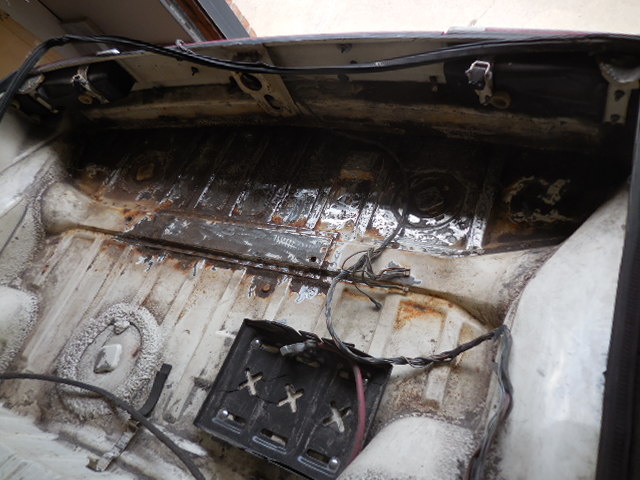

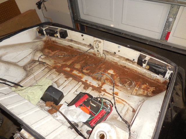

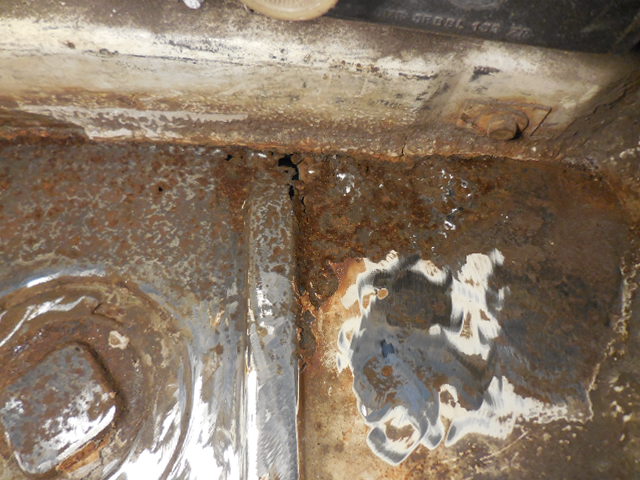

The car sat mostly covered in Indiana for 15 years however the tarp that was used, didn't quite cover the rear 2' or so of the car. I have ground the majority of the rust from the rear trunk pan.

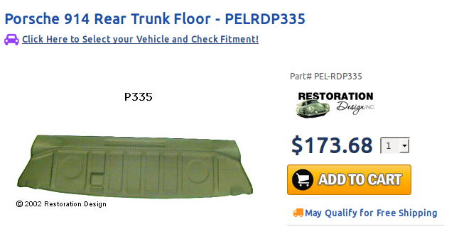

Should I replace cut out and reweld the hole spot and cover the trunk with something or cut out the rear trunk pan and weld in a new one?
Before
After
Hole

brettrarnold   The car sat mostly covered in Indiana for 15 years...   Jul 24 2019, 04:46 PM
76-914   Replace it. One of the easier pieces to do. Re: op...   Jul 24 2019, 05:33 PM
brettrarnold   Replace it. One of the easier pieces to do. Re: o...   Jul 24 2019, 05:54 PM
