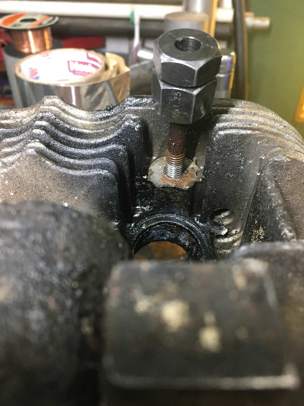

As usual, there were the typical seized exhaust studs. Ended up using one of my favorite tools to extract the studs.

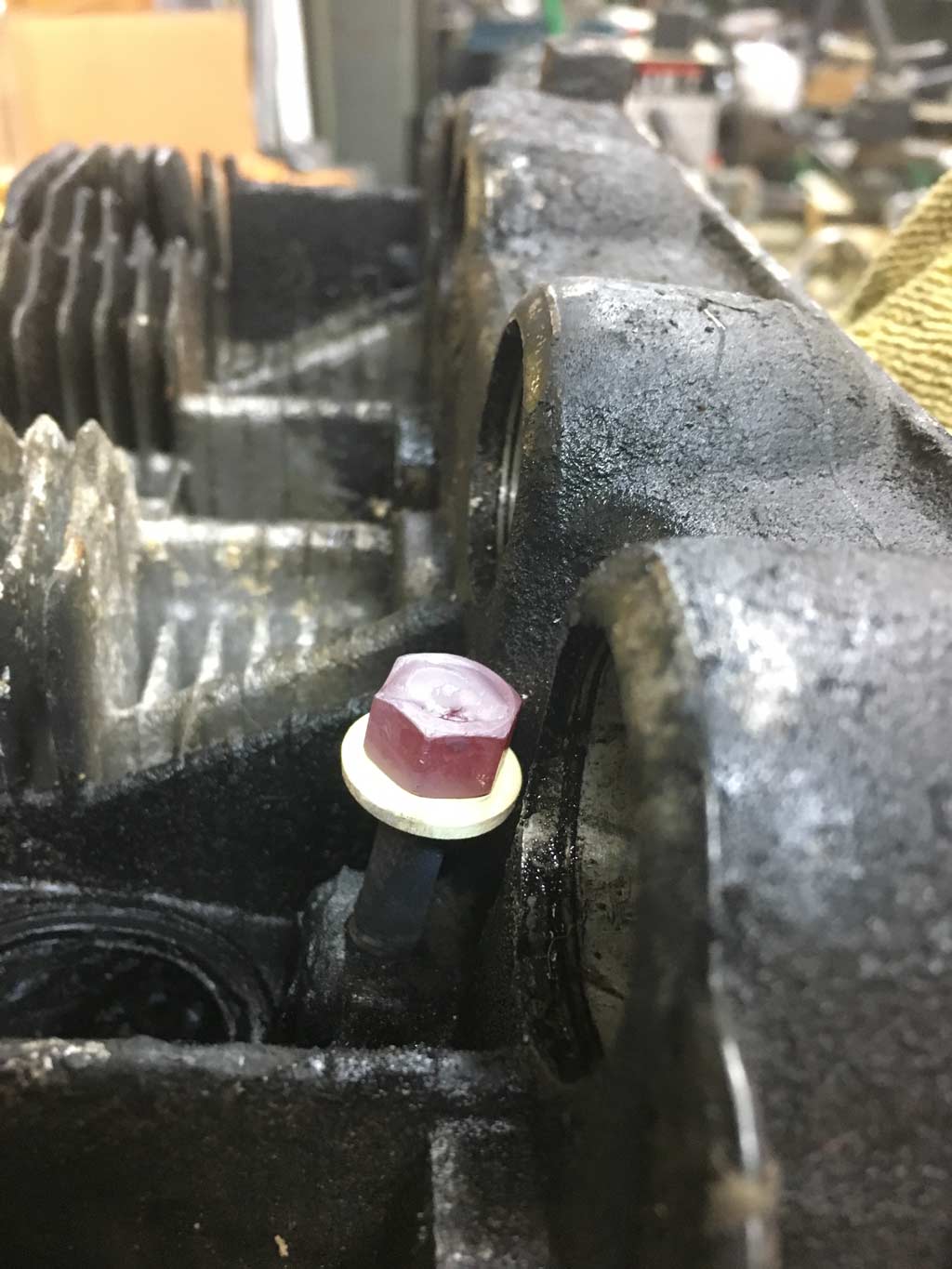

This tool plus a little heat usually works. But, of course, there is always the one stud that someone broke off leaving no threads. Tried the usual tricks. . .penetrating oils . . . heat . . . vice grips. Finally resorted to the heavy artillery & welded on a nut.
And of course the inevitable occurred.
We temporarily interrupt this post -- Clear the children from the room.

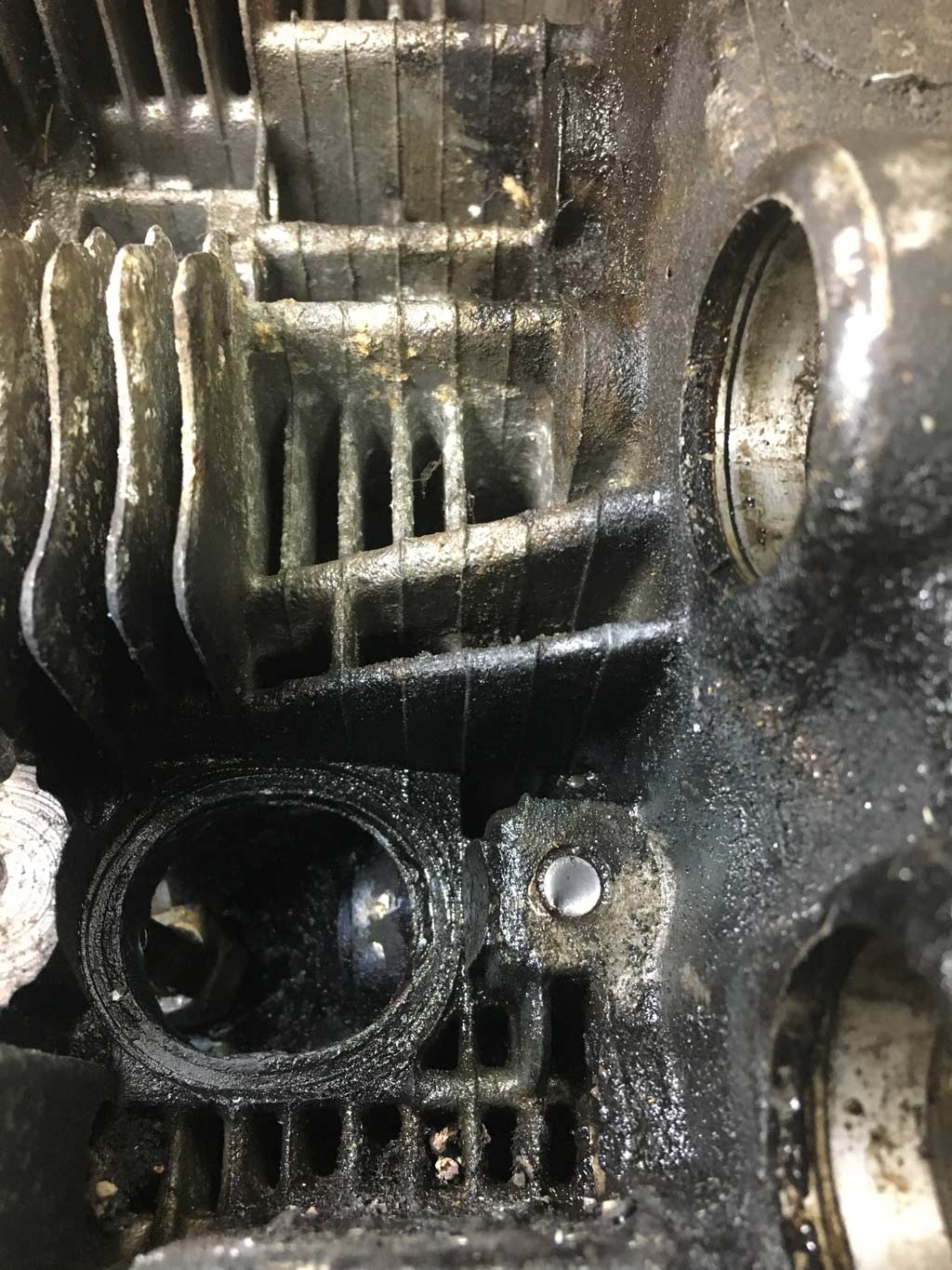

Guess we'll save that project for later. Need to bead blast the carbon off the combustion chambers and ports to see if there is cracking. If there isn't, then I'll deal with the broken stud by drilling it out in the mill using a left hand drill bit. If necessary it could be inserted but I prefer not to do that.
