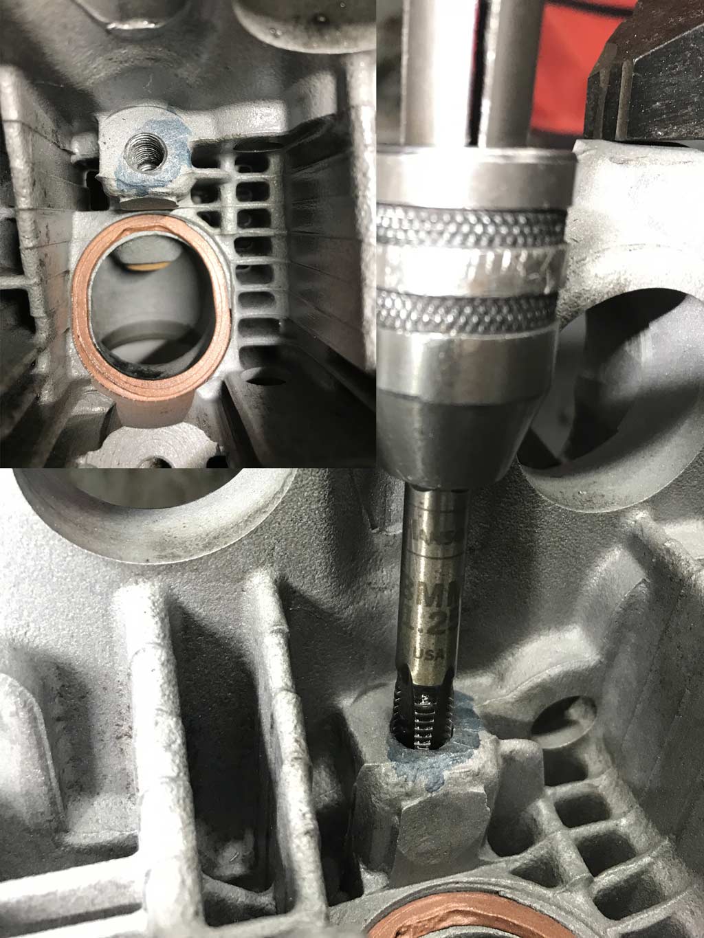

OK -- so I got the head set up in the mill and was able to get the broken stud out and salvaged the existing threads.
Here is the basic setup.
And here is the final result after a few hours of farting around. Not sure you guys want the gratuitous details on the interim steps. Will post if there is interest.
I feel better now. Two good heads - time to start sourcing new valves, springs, and valve guides. Good weekend so far! (IMG:style_emoticons/default/beerchug.gif)

QUOTE(Superhawk996 @ Jul 27 2019, 05:05 PM) *
OK -- so I got the head set up in the mill and was able to get the broken stud out.
Sure, rub it in (IMG:style_emoticons/default/beer.gif)
That really is awesome work. Those heads look beautiful.
