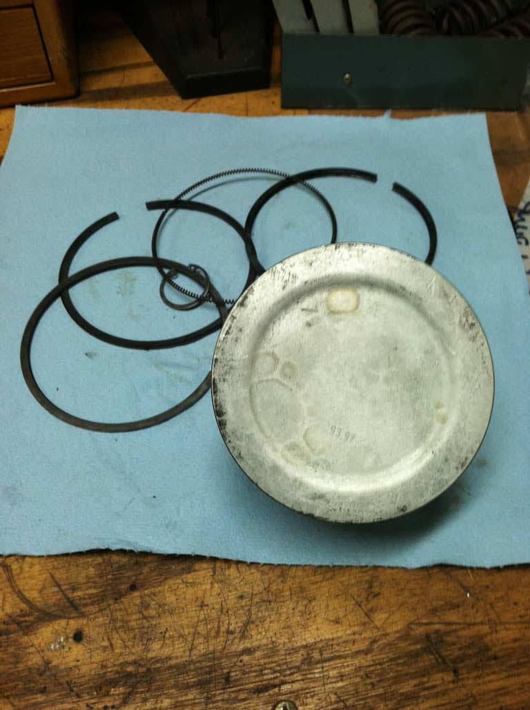

I started cleaning up the stock pistons from this 099 engine. Overall pistons seem to be in great shape. I need to measure them to make sure but likely will reuse them with new rings for this build.
I used the ultrasonic cleaner with some simple green but it still struggled to get some of the really tough carbon off. Wondering what cleaning solutions folks are using with better results.
Purple Power seemed to be in wide use based on quick troll of YouTube. (8/8/2019 post edit: Purple Power not recommended for Aluminum via their Website FAQ)
Could resort to carb cleaner but the smell of that stuff will permeate the garage in a hurry. Then the wife starts to complain as it makes it's way into the house.
