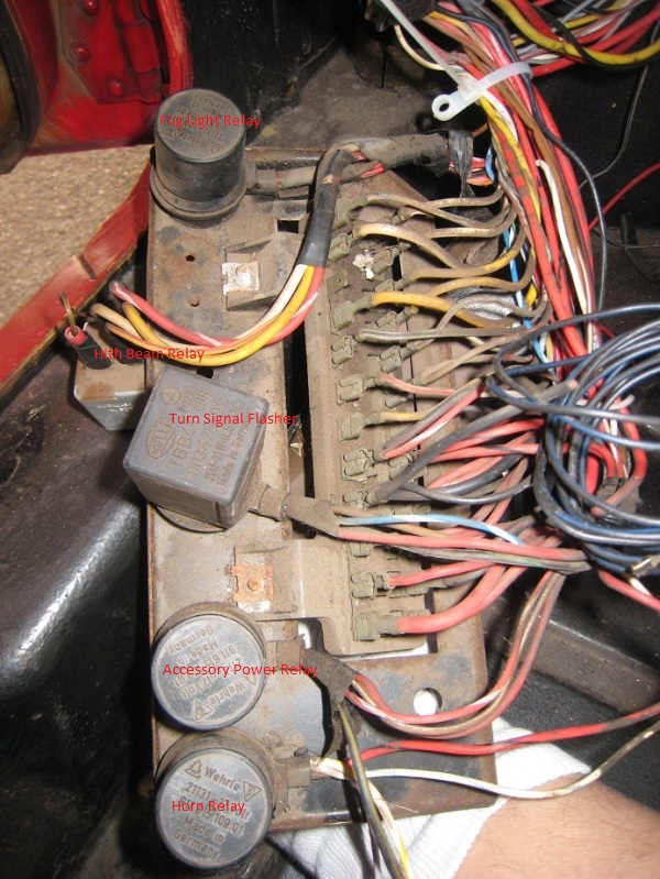

I saw a thread on here somewhere, but of course, I did not bookmark it, or add to it, and I can't find it now....
But I bought a new High Beam Relay or Headlight relay, whatever it is called. It has an extra blade (30 IIRC). On the thread that I can't find, it was noted that the extra post has to be jumped to one of the 4 others. Truthfully, that is what I can't remember. So does it jump to 56a, S, 56b or 56? And if anyone can find the thread, please add it here. Thanks, Clark |

I did find this picture of the back of the fuse/relay board under the dash. I see the extra post. Looks like it is going to the white wire. Not sure what terminal that is, but should be easy enough to figure out. But I would like confirmation before I burn up the relay doing it wrong. (IMG:style_emoticons/default/piratenanner.gif) |

jcd914 Here is an old thread on the new 5 terminal dimmer... Aug 1 2019, 12:40 PM
malcolm2 Excellent..... The thread title was misspelled. M... Aug 1 2019, 01:28 PM
dr914@autoatlanta.com I tried to be as thorough as I could in my book, I... Aug 1 2019, 01:31 PM

jcd914 There is a thread on switching over to an electron... Aug 1 2019, 05:22 PM
malcolm2 I got my original working. But i bought this one t... Aug 1 2019, 06:22 PM
malcolm2 UPDATE for future....
I found this picture and LI... Aug 6 2019, 03:08 PM
