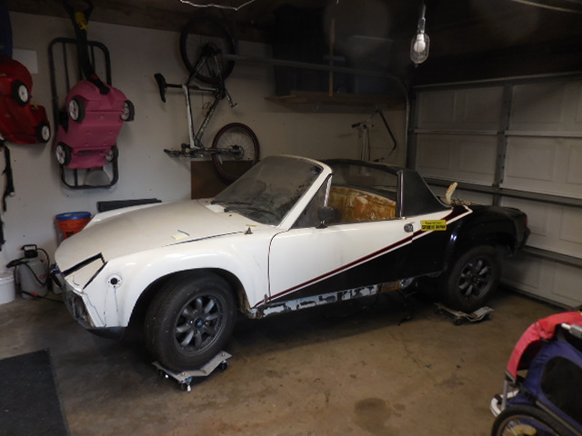

This car was the first car that Brett drove when he was 13 and was given to us in 2014. It had been sitting idle back in Indiana under a family friend's carport for the past 15 years before Brett went back to Indiana and towed it out to Colorado with his father in July 2014. (IMG:style_emoticons/default/piratenanner.gif)
When we got it, we didn't have a garage to work on it and it sat idle being stored outside for another year until we could afford a house with a garage. Colorado is pretty expensive so after we got a house with a garage, we then needed to save up more money to work on it.
Also I must mention in my ignorance, there were 3 distinct phases of thinking for getting this car fixed which I now find funny and are listed below
Phase 1: I will tow this car out to Colorado and get it the engine running for maybe $2,000 and have a working car.
Phase 2: Holy shit after researching this is impossible and will have to pay somebody to fix it for $15-20k.
Phase 3: I have enough local support and 914world resources and can fix this myself for around $10-15k.
Build-Off Challenge
So Amy and I are going to be tackling different aspects of this car so the posts will be coming from both of us. I will handling the rust/engine work and Amy will be on Interior and Exterior. Also she may help with some of the posting so we will start each post with name.
Brett
Step 1 (Complete) was to remove the engine and assess the frame rust situation. Never having removed an engine from a car, this was an extremely daunting task. The steps listed in Pelican Parts tutorial - 914 Engine Removal Made Easy is by far the most difficult thing I have done to a vehicle thus far. Hell I don't even know the difference between a camshaft and a carburetor much less a CV joint or a clutch cable. But after staring at it for about 2 weeks, I decided to just start unhooking shit and labeling. Made a ton of progress and finally got the engine about 95% unhooked. Had a friend come over to help me out and we actually got it out. WOOHOO!!!
Step 2 (Complete) is to strip out all the interior. I ordered chassis braces and other misc items from Tangerine racing and am still in the process of identifying all the rust areas that need repair.

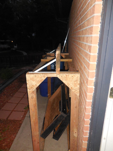

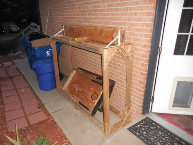

  1. Anyone in the Colorado area want my car stand? It measures 50" long x 73"wide x 22"tall. The width is a little wide for the 914 but all else works well. It has a little shelf for mounting a jack and lifting the rear end up and down easier.

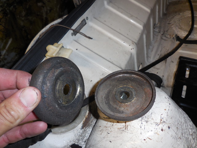

  2. What is this metal disk? i think it comes from the suspension somewhere but i couldn't figure it out.

mepstein   #37 https://nemigaparts.com/cat_spares/pet/pors.....   Aug 11 2019, 09:39 PM
brettrarnold   #37 https://nemigaparts.com/cat_spares/pet/pors....   Aug 11 2019, 09:45 PM
