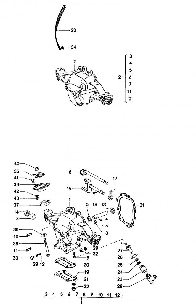

QUOTE(mepstein @ Aug 11 2019, 09:39 PM) *
When i am doing the subaru transmission mount would i need these?

mepstein   #37 https://nemigaparts.com/cat_spares/pet/pors.....   Aug 11 2019, 09:39 PM
brettrarnold   #37 https://nemigaparts.com/cat_spares/pet/pors....   Aug 11 2019, 09:45 PM
