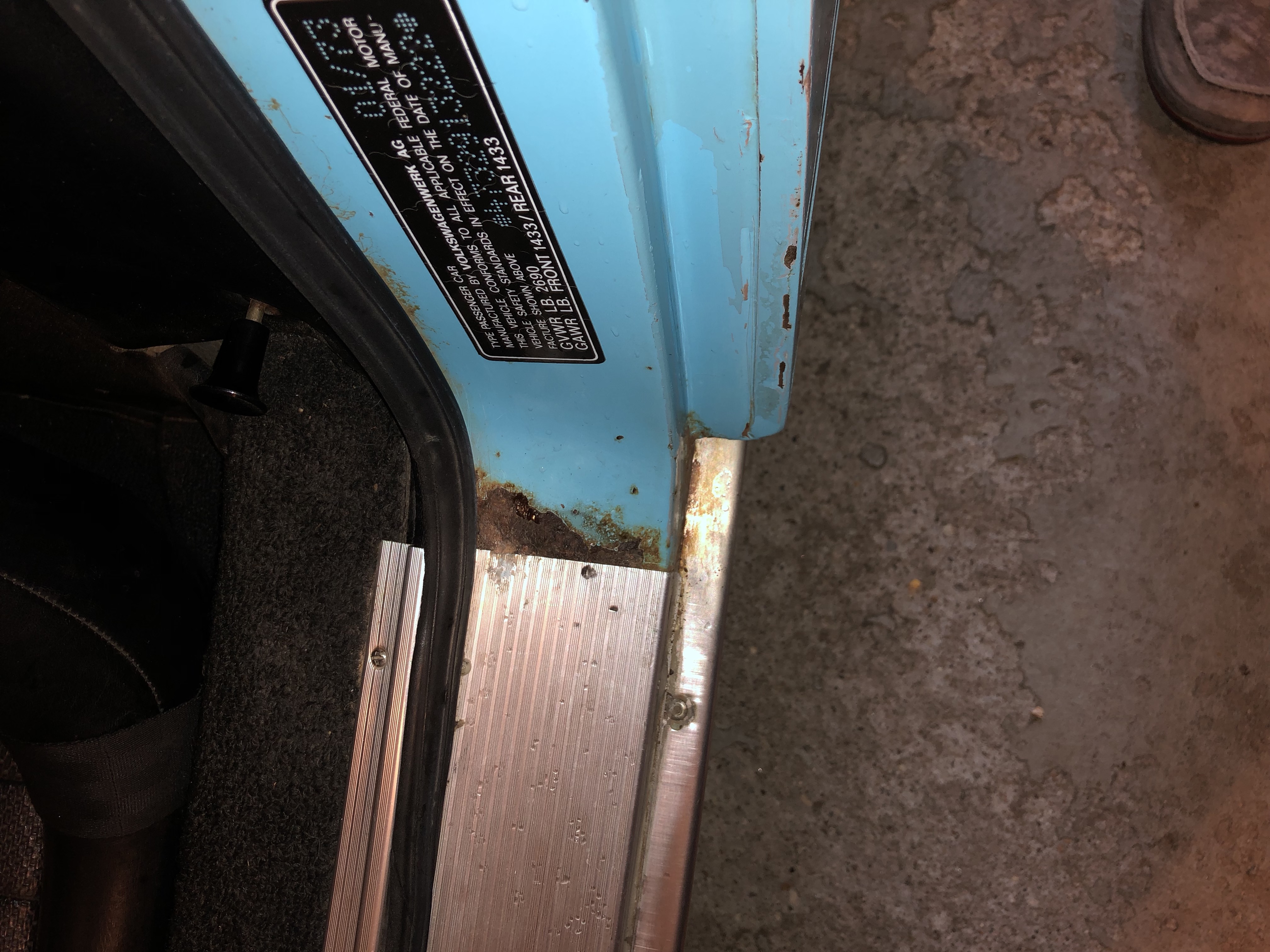

Thanks for the feedback so far. Here is a pic of the door sill area. Due to the size of the files, I'm being limited to I pic at a time. The fenders and front trunk area look great with only minor surface rust. There is some rust inside the back of the rear trunk floor with a couple of tiny holes (not the drainage holes).
The car smokes from oil dripping on the exhaust and the 1st gear synchro grinds when down shifting unless I bring the car to a complete stop. Assuming a worst case total engine rebuild along with a tranny overhaul and new clutch, what $ am I looking at spending?
Any other watch outs for a car that has been sitting so long (wiring/rubber) that could be major expense?

QUOTE(Indyheel @ Aug 18 2019, 09:12 AM) *
Reduce the size of your pictures if you are posting them directly from your computer, or put them in an online photo album and link to them.

bbrock   A couple thoughts from the jamb/sill pic. That is...   Aug 18 2019, 10:20 AM

JawjaPorsche   There is a lot of rust you can’t see. I would c...   Aug 18 2019, 10:43 AM
Larmo63   :agree: Walk away unless you have lots of patien...   Aug 18 2019, 11:37 AM

Superhawk996   :agree: Run Forrest, Run . . . .   Aug 18 2019, 11:56 AM

mepstein   When the sill looks like this, it’s usually the ...   Aug 20 2019, 08:28 PM
