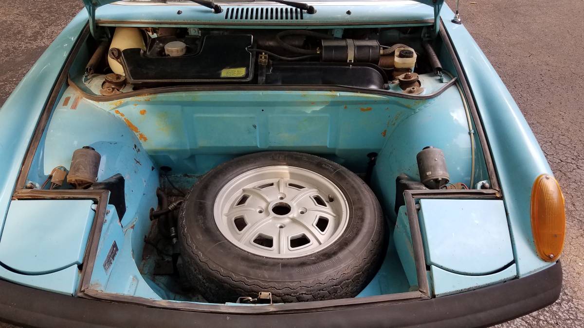

Hi Everyone,

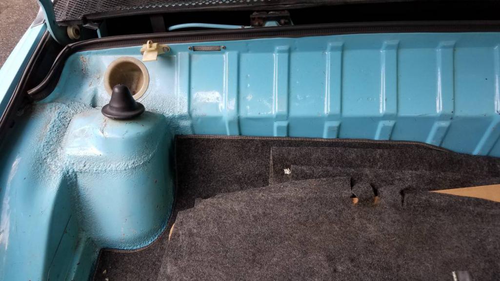

I'm new to the 914 world and am looking at a '73. The car is from Colorado and was dry stored for 23 years. Car is relatively rust free with the exception of a small area by the drivers door sill. I've attached pics of the battery area. Would do you think?

DickSteinkamp   Looks like someone torched out the floor of the ba...   Aug 18 2019, 10:04 AM
rjames   The battery tray can easily be replaced. What does...   Aug 18 2019, 10:06 AM

bbrock   A couple thoughts from the jamb/sill pic. That is...   Aug 18 2019, 10:20 AM

JawjaPorsche   There is a lot of rust you can’t see. I would c...   Aug 18 2019, 10:43 AM
Larmo63   :agree: Walk away unless you have lots of patien...   Aug 18 2019, 11:37 AM

rjames   Owner has had it less than a year and is now tryin...   Aug 18 2019, 12:06 PM

bbrock   I agree with pretty much everything already said. ...   Aug 18 2019, 02:44 PM

sixnotfour   youall this is the kill shot....... battery tray i...   Aug 21 2019, 12:37 PM
Rand   Dr said it's an easy fix and he has the part a...   Aug 21 2019, 01:19 PM
