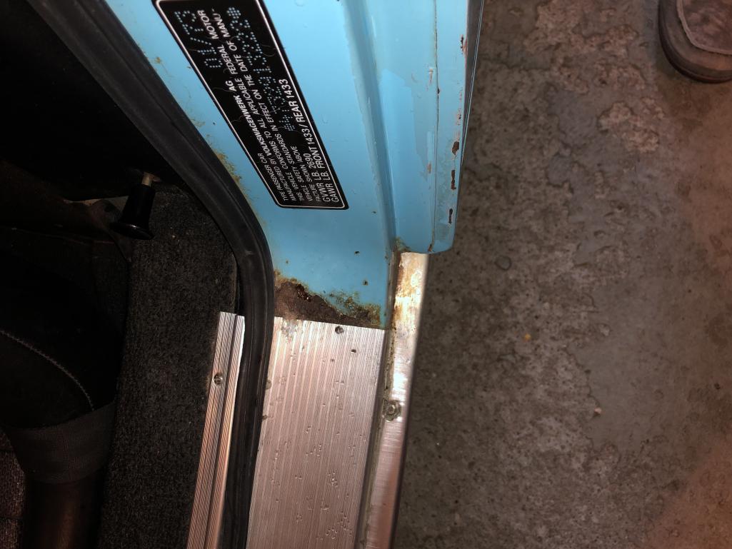

I'm new to the 914 world and am looking at a '73. The car is from Colorado and was dry stored for 23 years. Car is relatively rust free with the exception of a small area by the drivers door sill. I've attached pics of the battery area. Would do you think?

When the sill looks like this, it’s usually the tip of the iceberg.
It’s typically called surface rust by a seller and big $$$ repair from a shop.
Hint - it’s always a lot worse under the cosmetic aluminum threshold plate where the water wicks in and sits on the metal and the backside of the door that traps dirt that then holds moisture against the sill.
