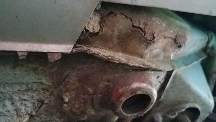

I'm new to the 914 world and am looking at a '73. The car is from Colorado and was dry stored for 23 years. Car is relatively rust free with the exception of a small area by the drivers door sill. I've attached pics of the battery area. Would do you think?

DickSteinkamp   Looks like someone torched out the floor of the ba...   Aug 18 2019, 10:04 AM
rjames   The battery tray can easily be replaced. What does...   Aug 18 2019, 10:06 AM

bbrock   A couple thoughts from the jamb/sill pic. That is...   Aug 18 2019, 10:20 AM
Indyheel   Here is the underside of the drivers door sill. T...   Aug 18 2019, 10:23 AM
rjames   Here is the underside of the drivers door sill. ...   Aug 18 2019, 10:35 AM
Spoke   Here is the underside of the drivers door sill. ...   Aug 18 2019, 11:36 AM
JawjaPorsche   There is a lot of rust you can’t see. I would c...   Aug 18 2019, 10:43 AM
Larmo63   :agree: Walk away unless you have lots of patien...   Aug 18 2019, 11:37 AM

Superhawk996   :agree: Run Forrest, Run . . . .   Aug 18 2019, 11:56 AM

rjames   Owner has had it less than a year and is now tryin...   Aug 18 2019, 12:06 PM
DickSteinkamp   I've seen worse. After a careful inspection...   Aug 18 2019, 01:30 PM

bbrock   I agree with pretty much everything already said. ...   Aug 18 2019, 02:44 PM

mepstein   When the sill looks like this, it’s usually the ...   Aug 20 2019, 08:28 PM
