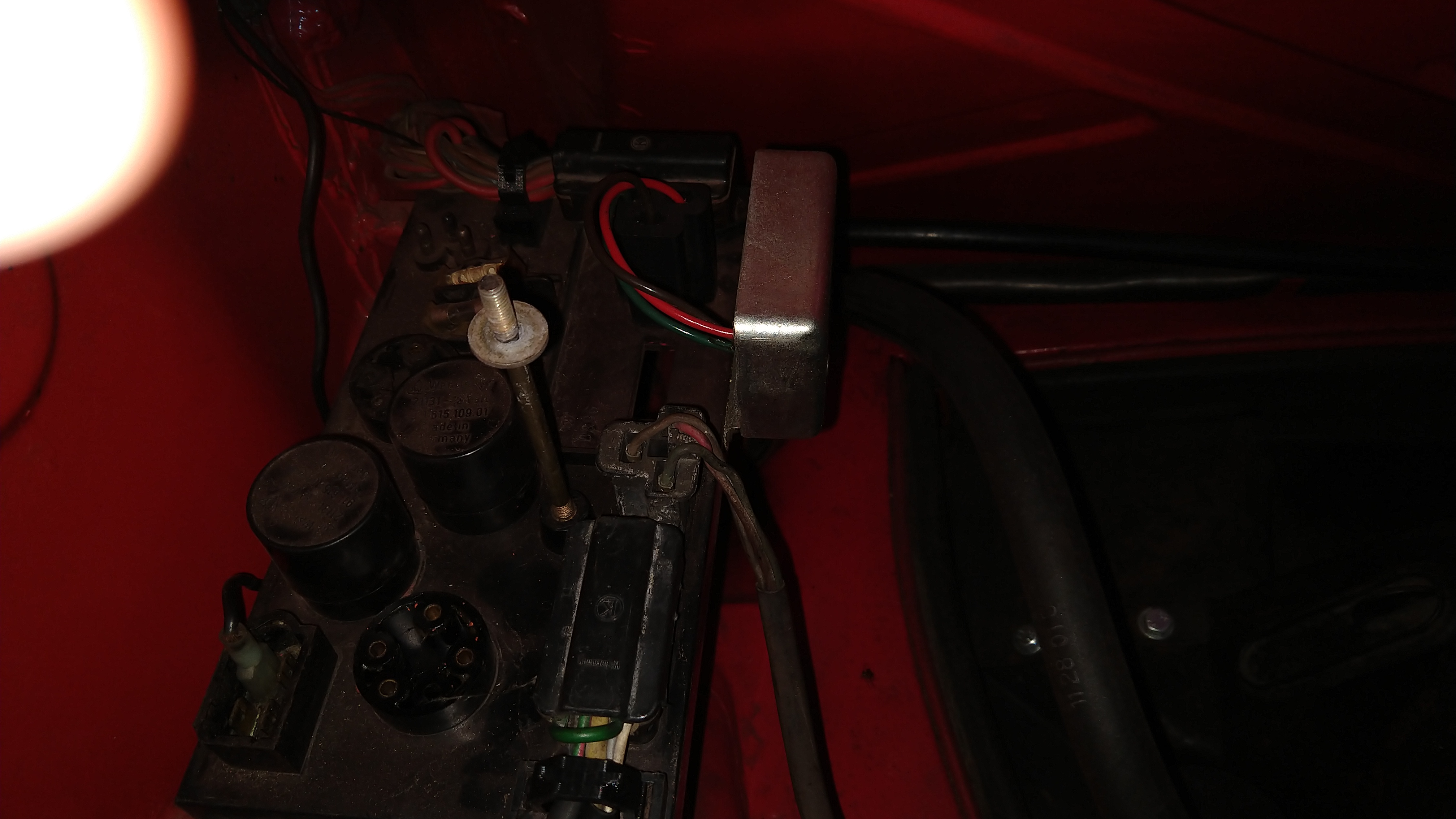

Dumb question: if the VR is in place, where do I get a reading on D- ? Seems all connections are obscured, no available point for probe......
GN
Spoke
post Sep 5 2019, 03:58 PM
Jerry
Posts: 7,438
Joined: 29-October 04
From: Allentown, PA
Member No.: 3,031
QUOTE(Gatornapper @ Sep 5 2019, 12:59 PM) *
GN
The D- signal can be found on the cable from the alternator. Below is my 914 showing the cable and its connector. You should be able to measure right on the connector with the VR left in place.
The VR I have was purchased at my local FLAPS and works very well. 14V all day.
