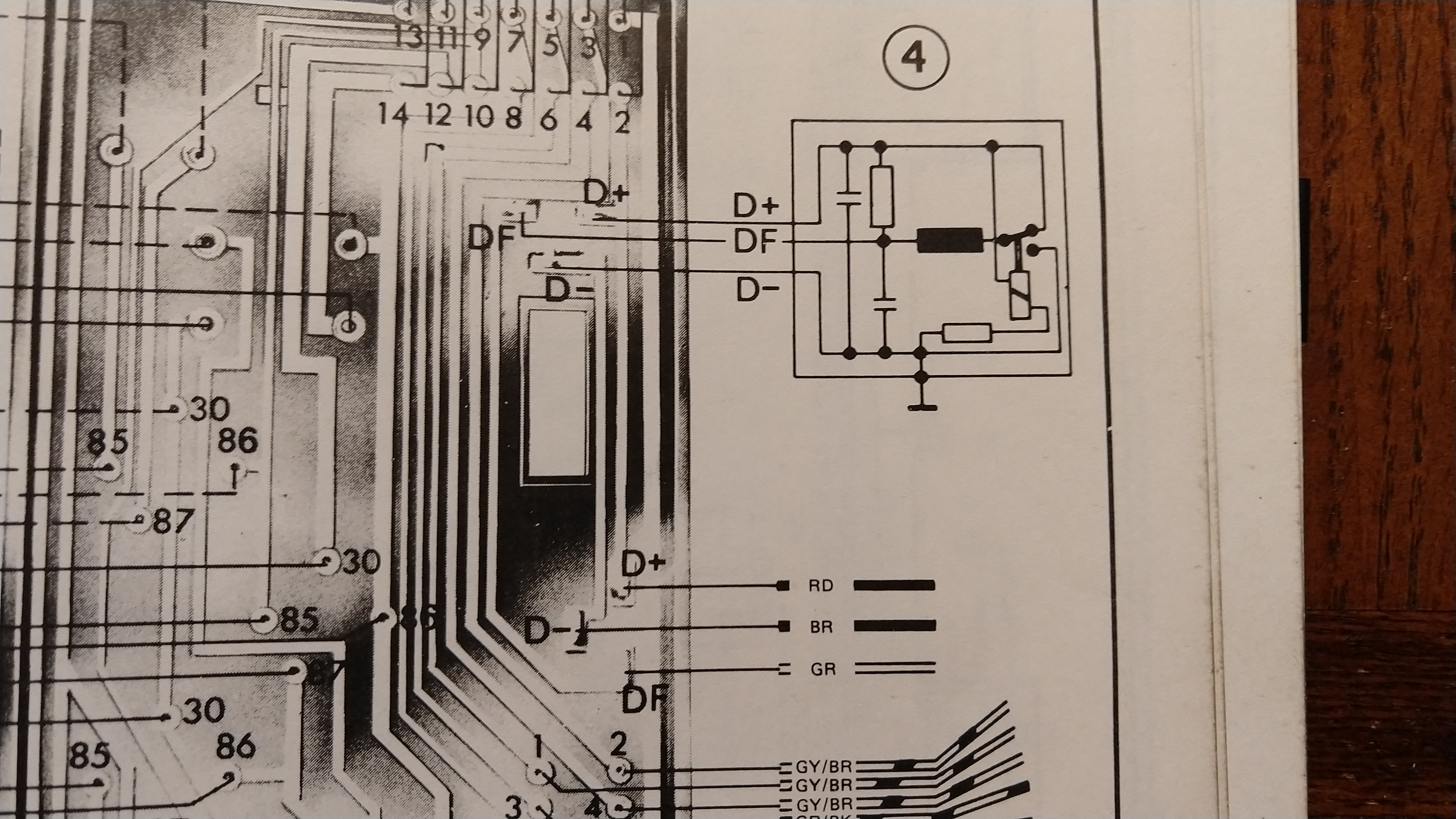

Took the car out for a drive today, planning on going to dinner. everything is working as it should. getting on the PA turnpike and I had to accelerate briskly to get into traffic, and a moment later I noticed that the RED alternator light had come on. Pulled of at a wide spot to check the belt and wires and shut it off. Not checking the belt with it running. Belt good, plug tight, tapped the VR a couple times for good measure and started it back up. Light still on and now my Autometer AFR gauge just had bars. I know that is because it doesn't turn on until the voltage is +13v So not charging.
Now I am on a limited access highway with the next exit `12-15 miles away. Good thing had the battery fully charged on the tender before I left the house. So I made it to the next exit, turned around and headed back home for a total of 35 miles on battery only. Whew. But that shot dinner.....
Replace the VR with another I had that previously tested good. still no charging. checked the plug on the relay plate again. looks good.
I have not yet checked the wire connections at the alternator, possibly a wire vibrated loose during the brisk acceleration.
Now the question
I read to test the VR to short between D+ and DF and if the alternator is good voltage at the battery will go to alternator maximum of about 15-16V
So do I REMOVE the VR for this test? and jump between the D+ and DF at the relay plate.
OR
Leave the VR in place and short between those pins?

This diagram shows which signals are which.
In this diagram, DF goes to DF, D- to D- and nothing else.
D+ goes to D+ then onto pin 2 of the 14 pin connector going to the cabin and to the GEN bulb.
