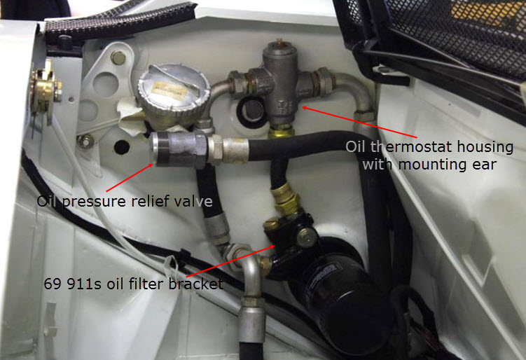

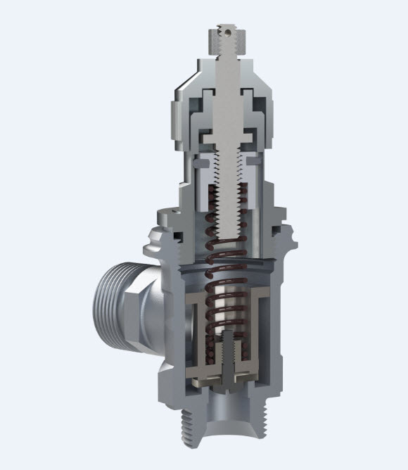

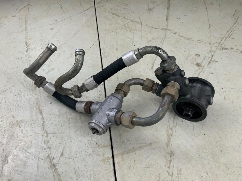

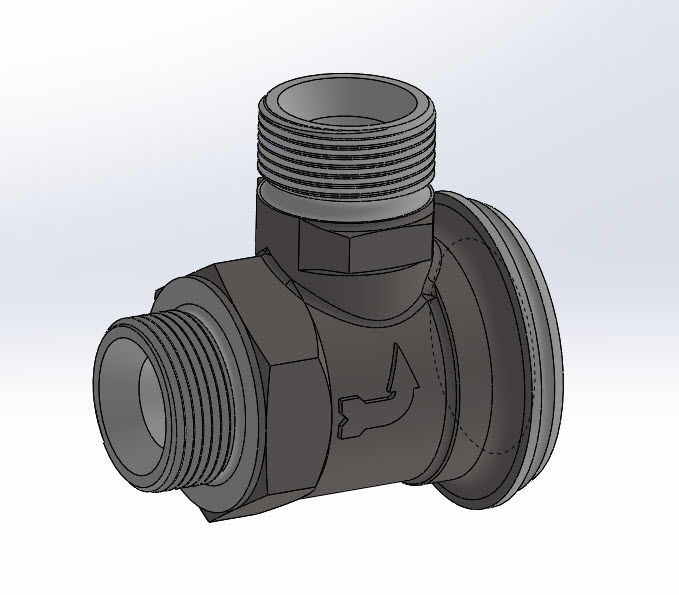

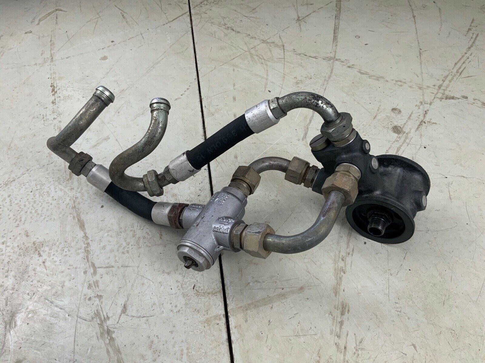

The GT oil system is of course a challenge.
These are 3 vital components that are really difficult to come by/expensive
Luckily this is old school technology and possible to reverse engineer and replicate. At least the thermostate and oil pressure relief valve. Casting the oil filter bracket is a bit trickier, and most of them are magnesium also..

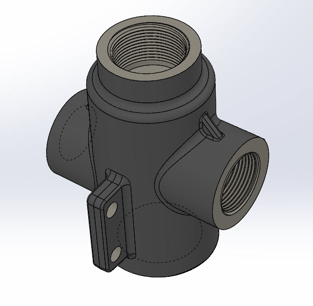

Thermostate housing 3D-model
OPR-valve 3D model (cast part)
3D-model of opr-assembly

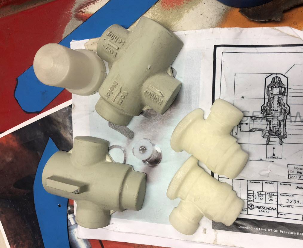

Plugs (is it called that..?) for sand casting (I have a guy who is going to do the metal casting).
Work in progress, very exciting

Cool project.
This just happens to be on Ebay right now.
Not affiliated.
