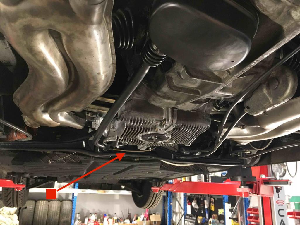

CheeRS   Engine returned today in the car. A lot of parts c...   Sep 9 2019, 02:06 PM
CheeRS   you can see it on this photo   Sep 9 2019, 02:07 PM
rhodyguy   That oil temp wire should be mounted on a stud beh...   Sep 10 2019, 07:50 AM
sportlicherFahrer   The oil temp wire plugs in to the main harness nea...   Sep 10 2019, 09:14 AM
