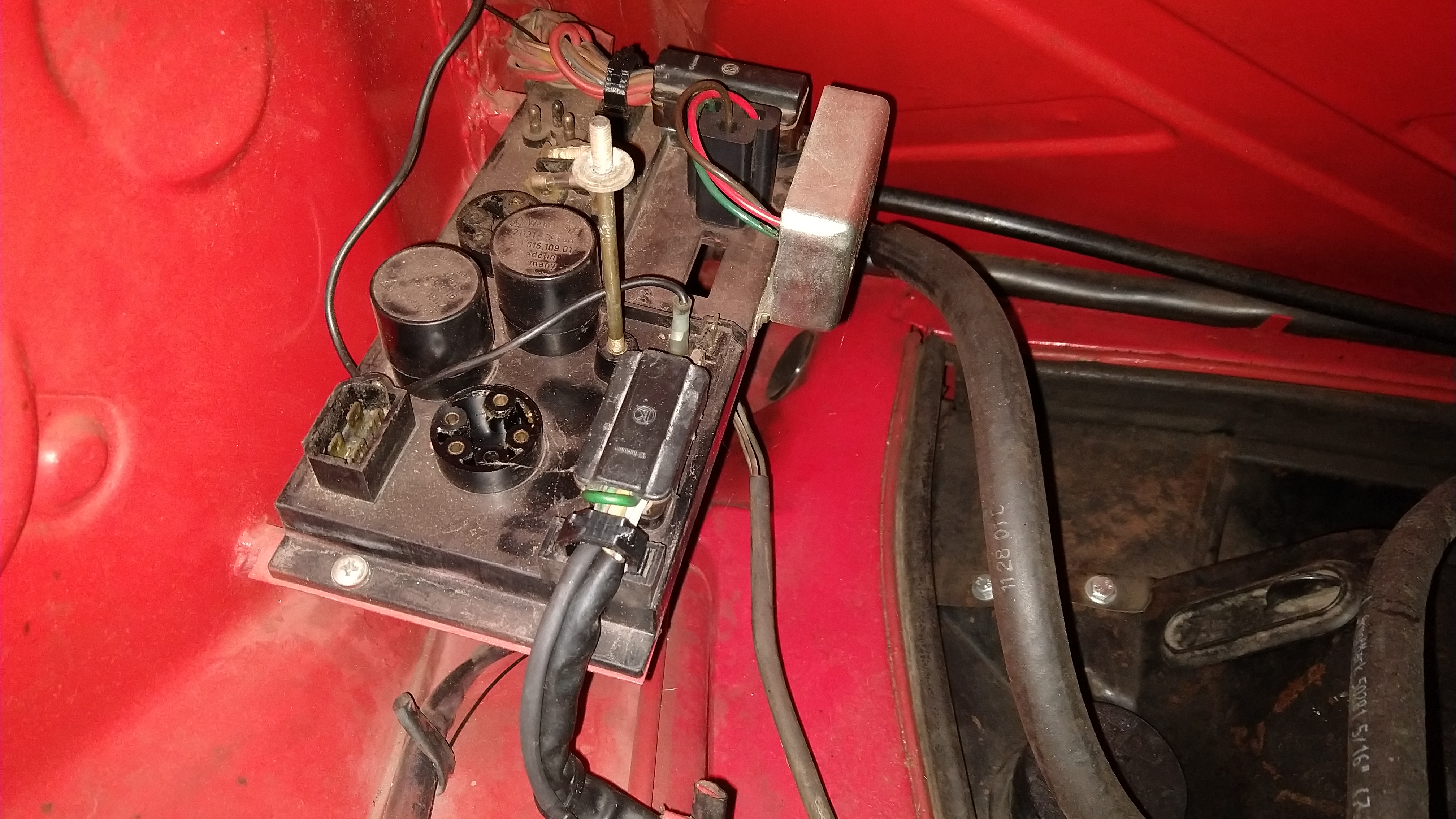

Here's a way to do a quick test on the VR. I just did this on my 914. The goal is to see if the VR will raise the voltage at DF.
There are 2 parts to this test. This is part 1; Isolation of the VR.
The set up for test 1 is as follows:
1) Remove the connector to the alternator. This will remove the load on DF and isolate the VR. This also removed the ground connection to the VR which will be reconnected in step 4.
2) Remove the power to the FI ECU (if you have FI). If you have carbs, remove the ground jumper from the FI connector on the relay board. This jumper powers the fuel pump. We want the fuel pump off.
3) Remove the 12V connector to the ignition coil. This keeps the points/Pertronix/electronic points from being powered. If you have some other electronic ignition system, remove 12V power from the unit.
4) Ground the D- pin at the alternator connector on the relay board. When you disconnect the alternator plug, the VR loses its ground. I used the jumper wire from the FI ECU connector for the fuel pump to ground D- as shown below.
5) Turn the ignition key to ON.
6) Observe that the GEN light is OFF.
7) At the alternator socket on the relay board, measure D+ to chassis and DF to chassis. On my car, I measured about 10.5V at both D+ and DF.
8) Turn the ignition key to OFF.
Notes:
At step 7, the VR on my 914 sensed only 10.5V and attempted to drive the armature via DF to a high voltage.
The resting voltage of the battery on my car was 12V. This seems low although all exterior marker lights (LEDs) were on as I've rewired the lights to come on when the ignition is ON.

Spoke   Here's a way to do a quick test on the VR. I j...   Sep 9 2019, 11:52 PM
Spoke   Part 2 of the VR test is to check the D+ and DF vo...   Sep 10 2019, 12:04 AM
