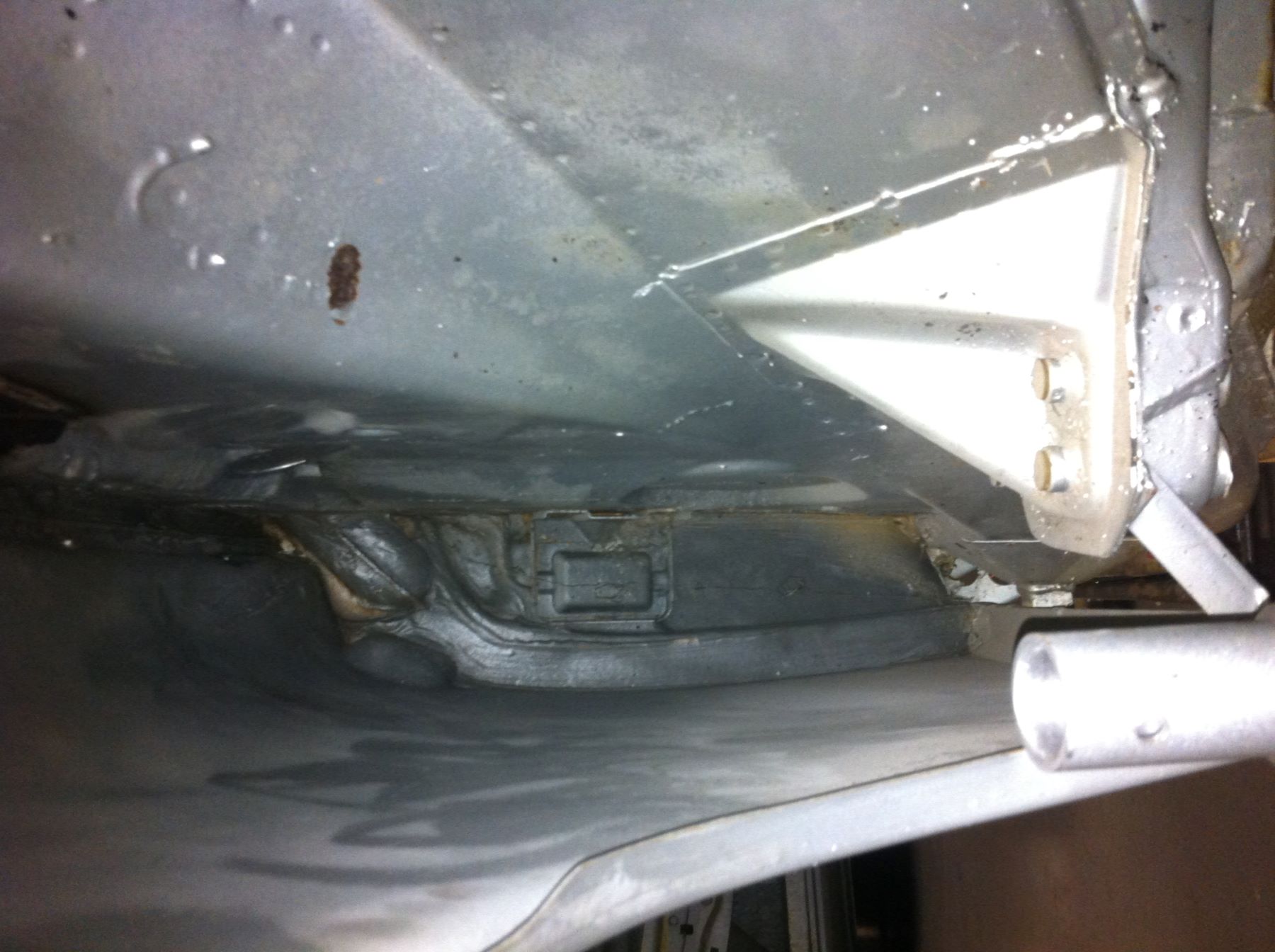

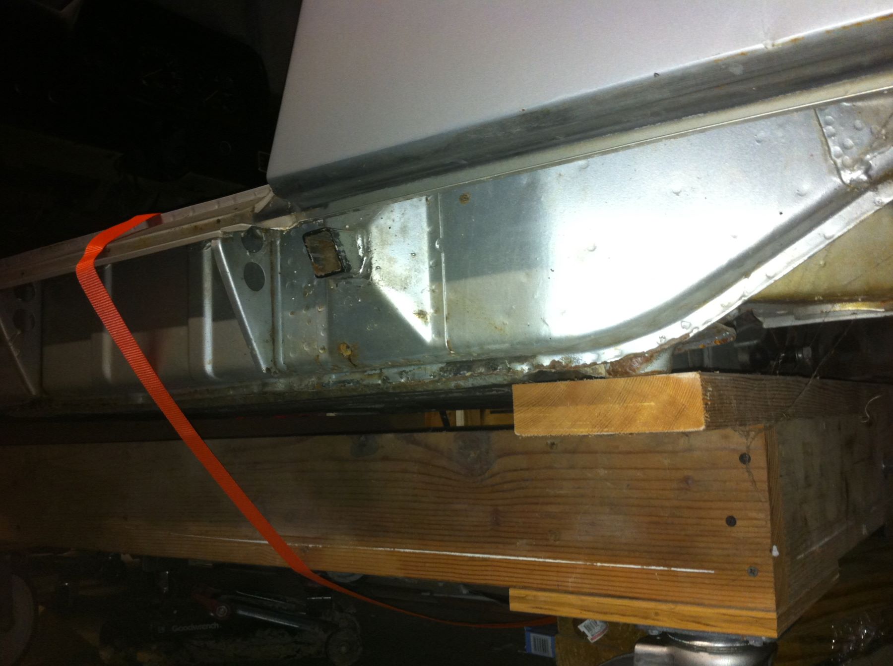

John   Well, I repaired the passenger side outer longitud...   Sep 2 2019, 08:33 PM

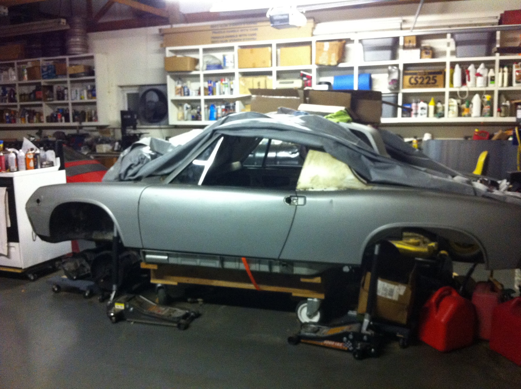

John   A couple of pictures of what I'm dealing with....   Sep 10 2019, 02:50 PM
