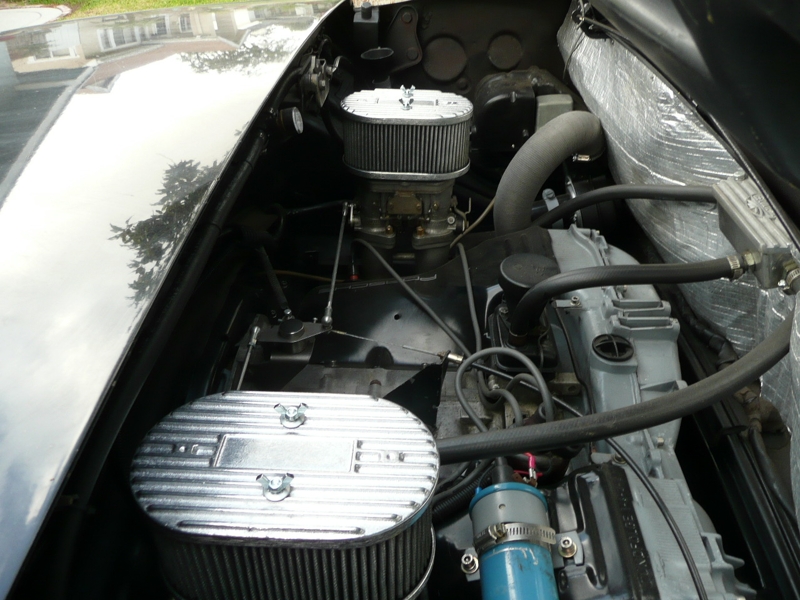

Someone, please, the equation for determining the diameter of a bellcrank to be used on a Weber 40 setup. Standard 914 accelerator cable length/throw (full close/full open) and standard Weber 40 butterfly. Also, anyone know of a source for such a bellcrank? Hope not to have to farbricate one myself. No lathe so will have to be with an electric drill for turning power. Extremely primitive.

I used the CSP bell crank linkage on my 2056, and it worked great.
Got it from Pierside Parts in Huntington Beach ... they had the best price ... https://www.piersideparts.net/CSP129941400.html
