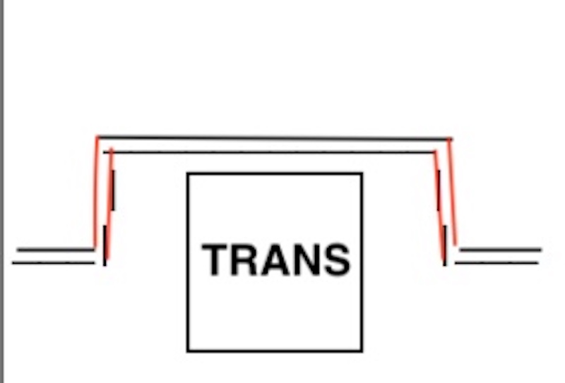

QUOTE(partwerks @ Sep 12 2019, 05:05 AM) *
I wonder if the adapter plate could be made with an offset, so it could come up higher?
Possibly.
Hard to tell how much 'wiggle room' you've got from the pic angles we're seeing. How much room is there between the sides of the trans in relation to the mounting points?
Also, measure the clearance above the trans to determine how much it can move up.
See if something like this will work for you. Modify the existing bracket to lower the mounting points on each side of the trans while leaving enough clearance that the top of the trans doesn't hit the trunk floor.
