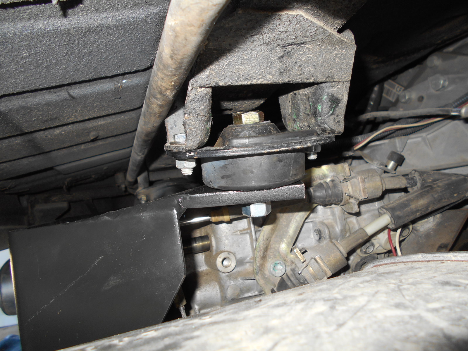

partwerks   Maintenace guy at work, and I made a new trans mou...   Sep 9 2019, 05:23 PM
SirAndy   Your transmission should be a good 2" higher ...   Sep 9 2019, 05:29 PM

Mike Bellis   Based on what I see, you have a compound angle lik...   Sep 27 2019, 10:33 PM
partwerks   Based on what I see, you have a compound angle li...   Sep 27 2019, 10:39 PM
Mike Bellis   Drive it a few hundred miles and check to see if t...   Sep 27 2019, 10:41 PM
