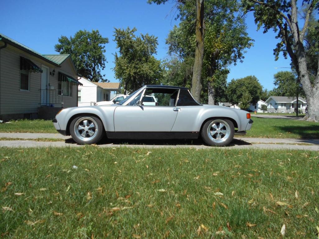

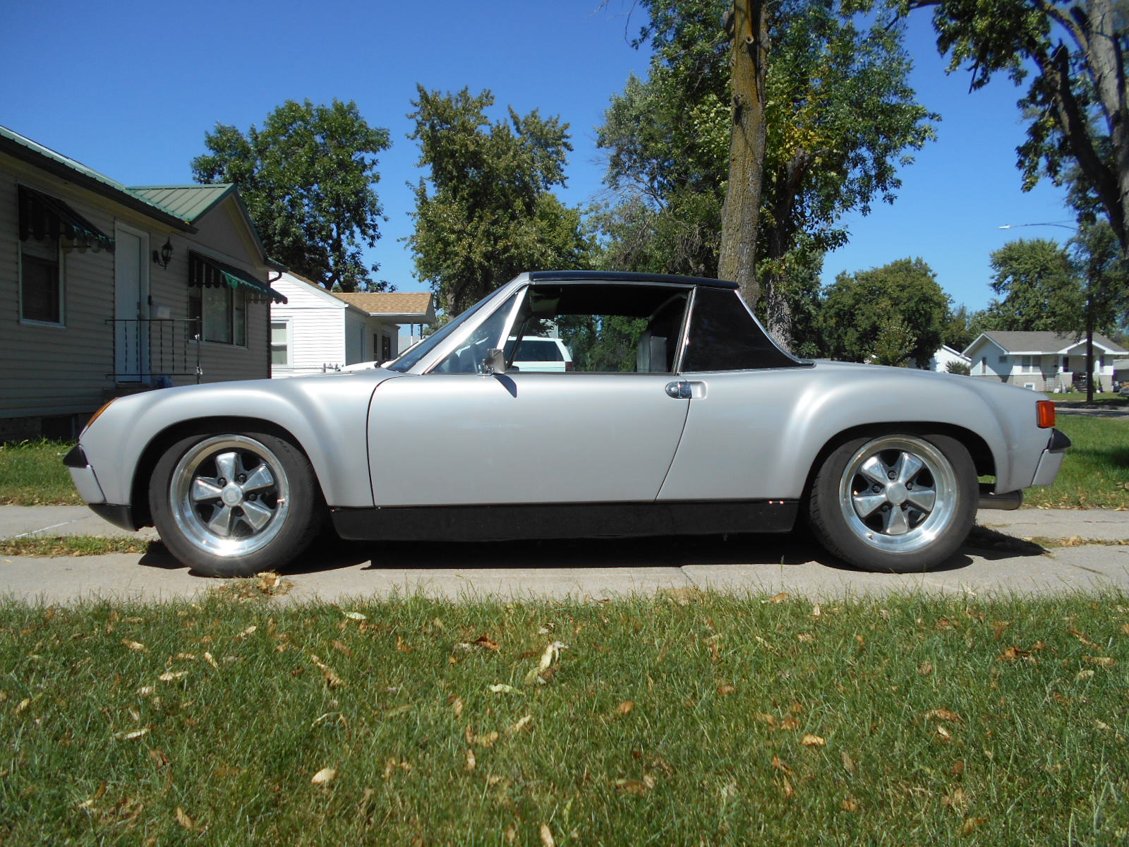

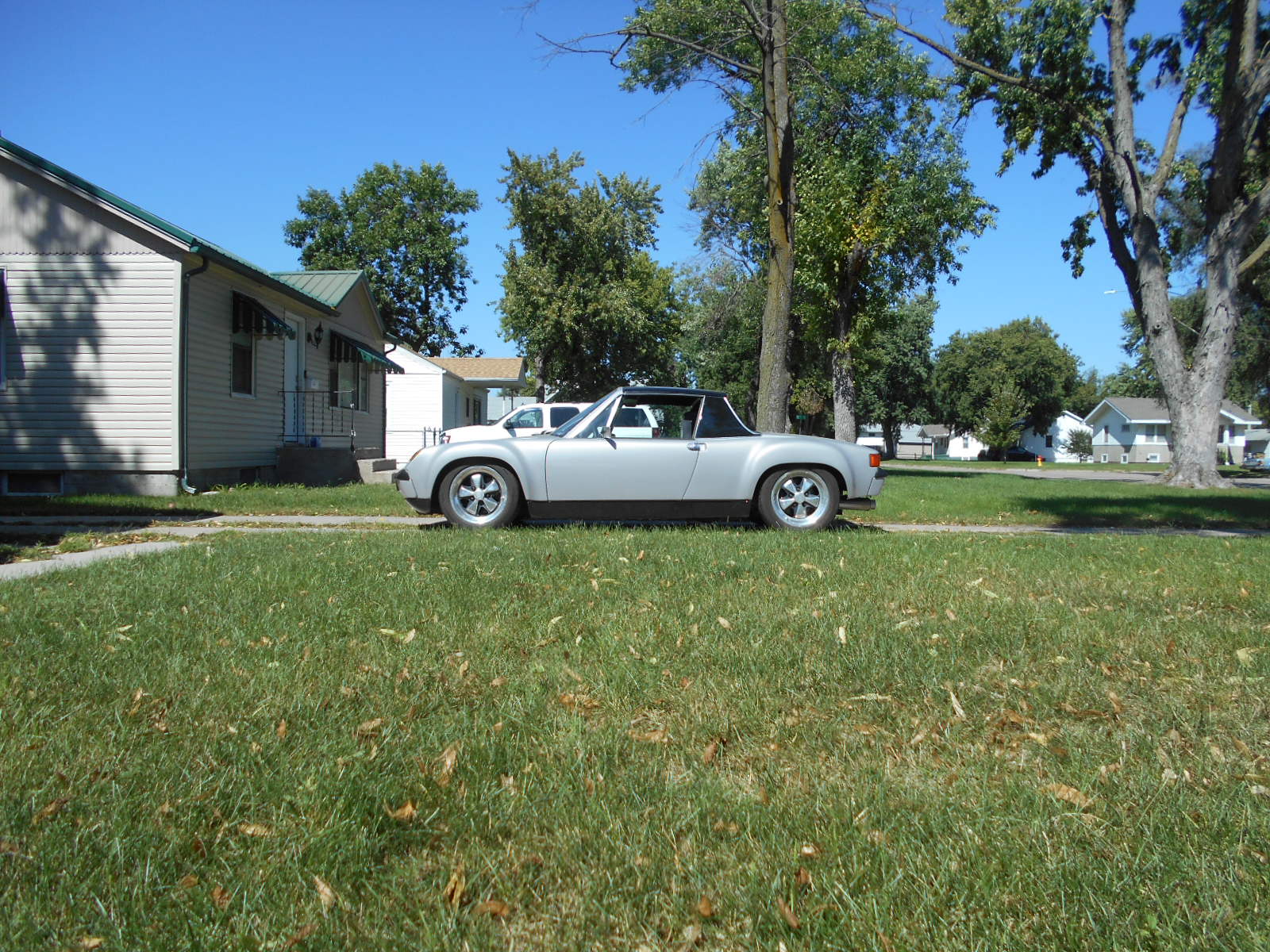

From my trans to my wheels, my axles go uphill at a 10 degree slope. Is that too much?
They angle forward a bit also, but it don't appear to be that much.

bdstone914   That rear end must be sitting very low. Badly gagg...   Sep 9 2019, 05:31 AM
914Sixer   Looks like aftermarket springs with spacer blocks.   Sep 9 2019, 05:56 AM
wndsrfr   Looks like aftermarket springs with spacer blocks...   Sep 9 2019, 06:35 AM
partwerks   So maybe need new springs?   Sep 9 2019, 06:04 AM
bdstone914   Hard to say. How does the car sit ? Cant see th...   Sep 9 2019, 06:34 AM
Andyrew   Can we see some pics of your trans mount and the s...   Sep 9 2019, 09:17 AM
SirAndy   Actually looks like the transmission is much lower...   Sep 9 2019, 10:16 AM
Andyrew   Ya I think the trans is falling off the hangers. P...   Sep 9 2019, 10:19 AM
