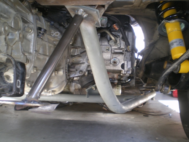

From my trans to my wheels, my axles go uphill at a 10 degree slope. Is that too much?
They angle forward a bit also, but it don't appear to be that much.

You can pick up another 2" if you delete the Porsche factory donut hanger at the trans and use the Subaru OEM trans support.

bdstone914   That rear end must be sitting very low. Badly gagg...   Sep 9 2019, 05:31 AM
914Sixer   Looks like aftermarket springs with spacer blocks.   Sep 9 2019, 05:56 AM
wndsrfr   Looks like aftermarket springs with spacer blocks...   Sep 9 2019, 06:35 AM
partwerks   So maybe need new springs?   Sep 9 2019, 06:04 AM
bdstone914   Hard to say. How does the car sit ? Cant see th...   Sep 9 2019, 06:34 AM
Andyrew   Can we see some pics of your trans mount and the s...   Sep 9 2019, 09:17 AM
SirAndy   Actually looks like the transmission is much lower...   Sep 9 2019, 10:16 AM
Andyrew   Ya I think the trans is falling off the hangers. P...   Sep 9 2019, 10:19 AM
partwerks   Maintenace guy at work, and I made a new trans mou...   Sep 9 2019, 05:23 PM
SirAndy   Your transmission should be a good 2" higher ...   Sep 9 2019, 05:29 PM
partwerks   Your transmission should be a good 2" higher...   Sep 10 2019, 06:06 PM
partwerks   Your transmission should be a good 2" higher...   Sep 11 2019, 08:30 PM
SirAndy   Also, why are your adjustable shocks all the way u...   Sep 9 2019, 05:32 PM

euro911   This is what it should look like http://www.914wo...   Sep 10 2019, 08:35 PM
euro911   I just noticed you're not running a 901 trans ...   Sep 11 2019, 11:09 PM
partwerks   I wonder if the adapter plate could be made with a...   Sep 12 2019, 06:05 AM
Andyrew   I wonder if the adapter plate could be made with ...   Sep 12 2019, 09:02 AM
euro911   I wonder if the adapter plate could be made with a...   Sep 13 2019, 12:40 PM
euro911   From my trans to my wheels, my axles go uphill at ...   Sep 12 2019, 01:57 PM

partwerks   Looks like at the top of that adapter plate...   Sep 13 2019, 01:35 PM

Andyrew   It's low but I've seen lower. I say modify...   Sep 15 2019, 08:15 PM

76-914   You can pick up another 2" if you delete the ...   Sep 16 2019, 09:20 AM

euro911   The stance (ride height) of your car looks fine. I...   Sep 23 2019, 01:56 PM

euro911   Certain things need to be identified. Is it an al...   Sep 25 2019, 05:16 PM
partwerks   Got it on the hoist, for a few better pictures. ...   Sep 25 2019, 06:44 PM
euro911   Can you shorten the upright sections of the trans ...   Sep 25 2019, 07:51 PM
partwerks   Can you shorten the upright sections of the trans...   Sep 25 2019, 08:12 PM
partwerks   Can you shorten the upright sections of the trans...   Sep 27 2019, 09:07 PM
euro911   Can you shorten the upright sections of the trans ...   Sep 28 2019, 03:59 AM
partwerks   [quote name='partwerks' post='2750756' date='Sep ...   Sep 28 2019, 08:11 AM
euro911   Not sure how heavy of springs are in there, but wo...   Sep 28 2019, 11:50 AM
ClayPerrine   [quote name='euro911' post='2750189' date='Sep 25...   Sep 28 2019, 08:04 PM
Mike Bellis   Based on what I see, you have a compound angle lik...   Sep 27 2019, 10:33 PM

Mike Bellis   Drive it a few hundred miles and check to see if t...   Sep 27 2019, 10:41 PM
euro911   Wow, well thought-out design, Clay. :first:   Sep 29 2019, 02:57 PM
