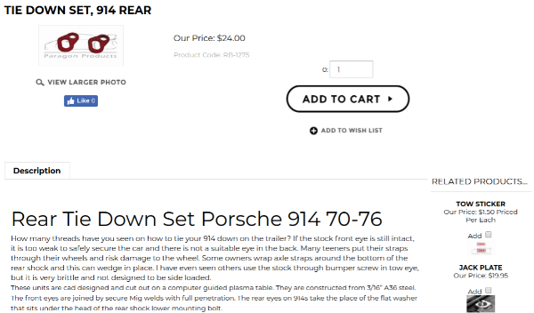

sixnotfour
post Sep 22 2019, 08:42 PM
Posts: 11,184
Joined: 12-September 04
Member No.: 2,744
these for the rear , and loop around front lower arm tube brace..

sixnotfour   these for the rear , and loop around front lower a...   Sep 22 2019, 08:42 PM
