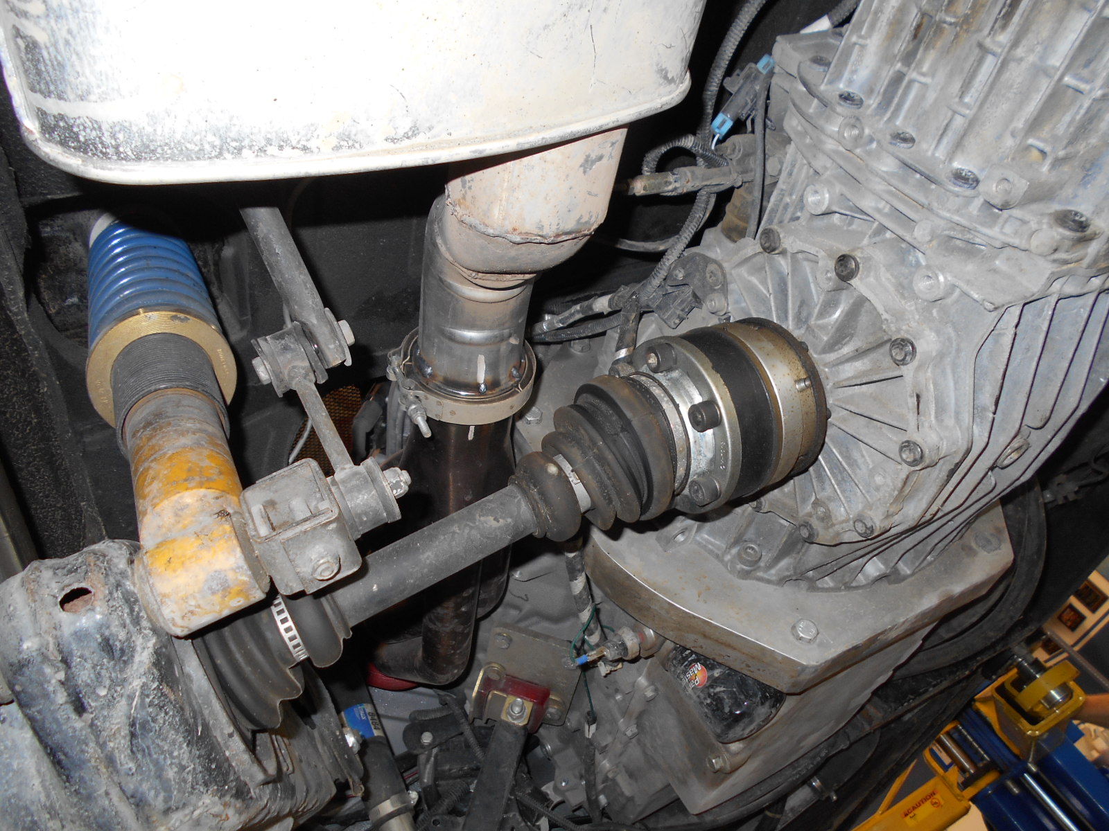

From my trans to my wheels, my axles go uphill at a 10 degree slope. Is that too much?
They angle forward a bit also, but it don't appear to be that much.

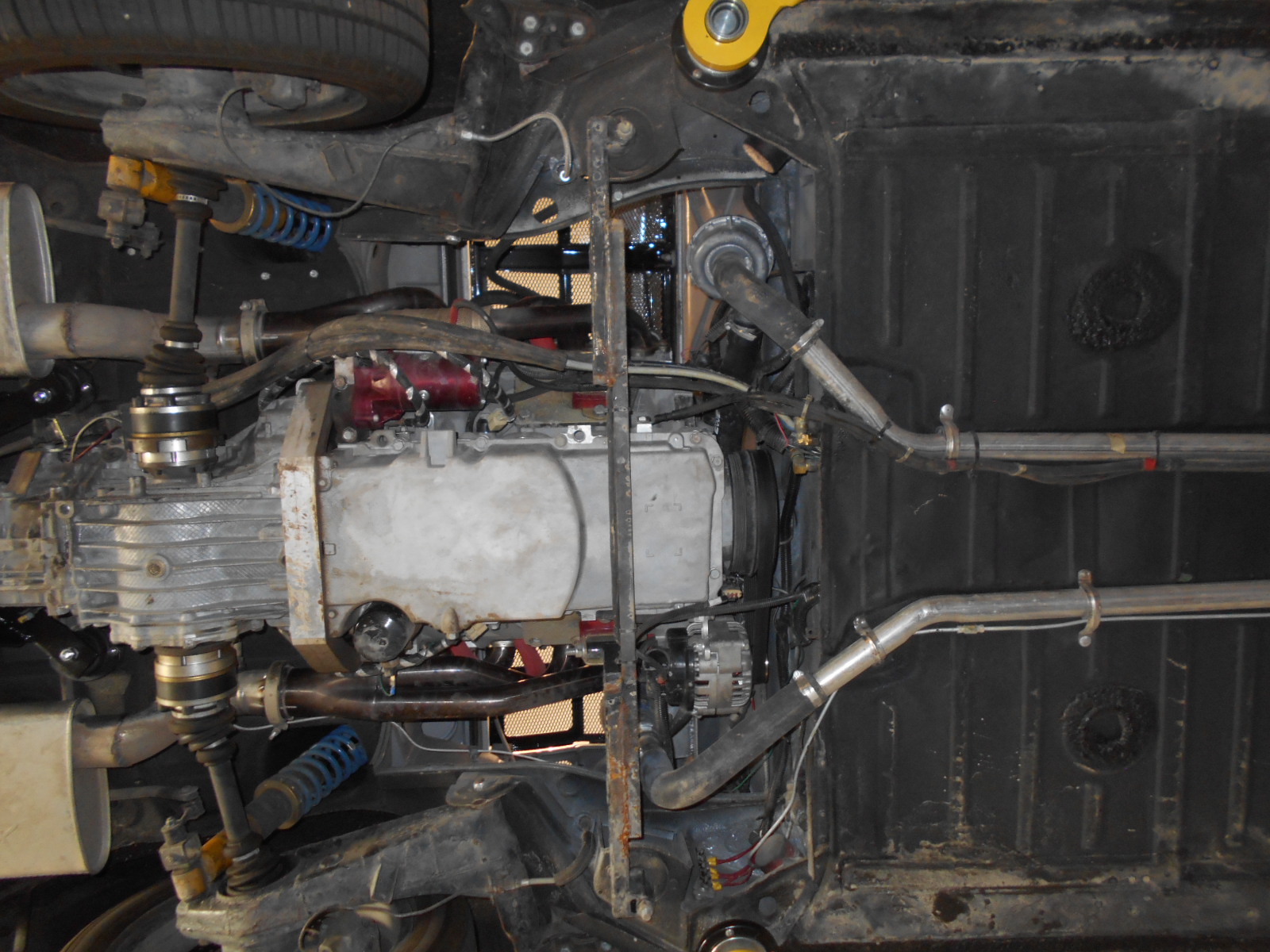

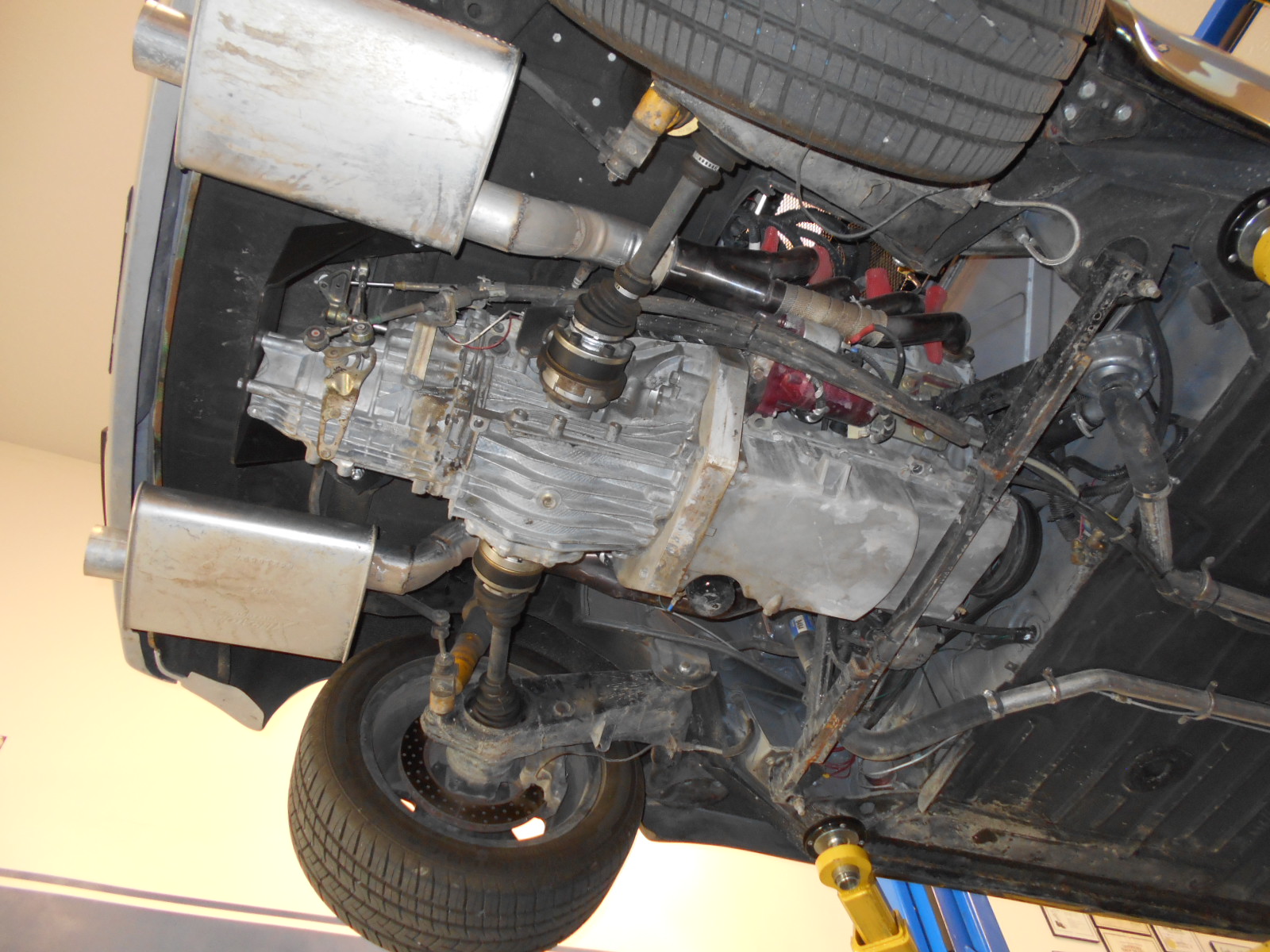

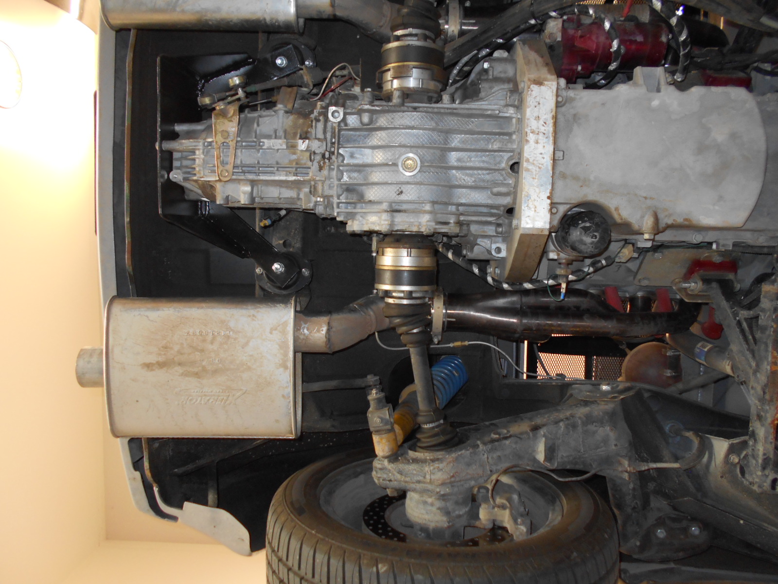

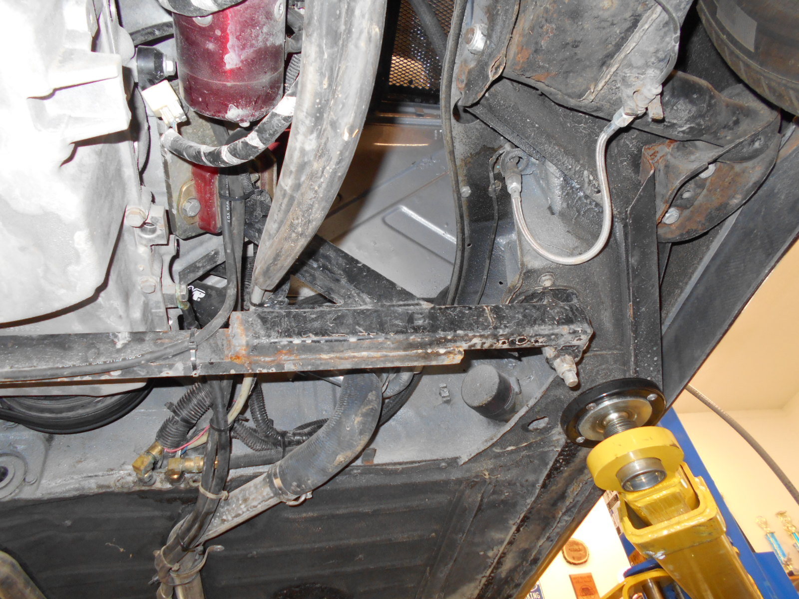

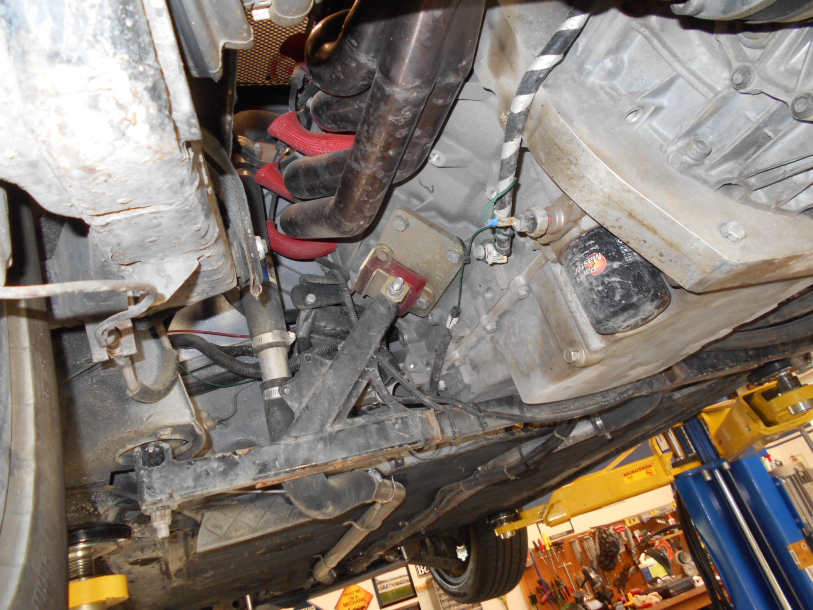

Got it on the hoist, for a few better pictures.

bdstone914   That rear end must be sitting very low. Badly gagg...   Sep 9 2019, 05:31 AM
914Sixer   Looks like aftermarket springs with spacer blocks.   Sep 9 2019, 05:56 AM
wndsrfr   Looks like aftermarket springs with spacer blocks...   Sep 9 2019, 06:35 AM
partwerks   So maybe need new springs?   Sep 9 2019, 06:04 AM
bdstone914   Hard to say. How does the car sit ? Cant see th...   Sep 9 2019, 06:34 AM
Andyrew   Can we see some pics of your trans mount and the s...   Sep 9 2019, 09:17 AM
SirAndy   Actually looks like the transmission is much lower...   Sep 9 2019, 10:16 AM
Andyrew   Ya I think the trans is falling off the hangers. P...   Sep 9 2019, 10:19 AM

euro911   Certain things need to be identified. Is it an al...   Sep 25 2019, 05:16 PM
partwerks   Got it on the hoist, for a few better pictures. ...   Sep 25 2019, 06:44 PM
euro911   Can you shorten the upright sections of the trans ...   Sep 25 2019, 07:51 PM
partwerks   Can you shorten the upright sections of the trans...   Sep 25 2019, 08:12 PM
partwerks   Can you shorten the upright sections of the trans...   Sep 27 2019, 09:07 PM
euro911   Can you shorten the upright sections of the trans ...   Sep 28 2019, 03:59 AM
partwerks   [quote name='partwerks' post='2750756' date='Sep ...   Sep 28 2019, 08:11 AM
euro911   Not sure how heavy of springs are in there, but wo...   Sep 28 2019, 11:50 AM

Mike Bellis   Based on what I see, you have a compound angle lik...   Sep 27 2019, 10:33 PM
partwerks   Based on what I see, you have a compound angle li...   Sep 27 2019, 10:39 PM
Mike Bellis   Drive it a few hundred miles and check to see if t...   Sep 27 2019, 10:41 PM
