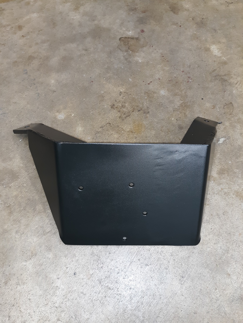

From my trans to my wheels, my axles go uphill at a 10 degree slope. Is that too much?
They angle forward a bit also, but it don't appear to be that much.

Can you shorten the upright sections of the trans mount to gain a couple inches of upward movement?

Are you saying to cut the flat bars loose on top of the main bracket, and jack the trans up higher, and then reweld the flat bars?

Andyrew   Can we see some pics of your trans mount and the s...   Sep 9 2019, 09:17 AM
SirAndy   Actually looks like the transmission is much lower...   Sep 9 2019, 10:16 AM
Andyrew   Ya I think the trans is falling off the hangers. P...   Sep 9 2019, 10:19 AM
partwerks   Maintenace guy at work, and I made a new trans mou...   Sep 9 2019, 05:23 PM
SirAndy   Your transmission should be a good 2" higher ...   Sep 9 2019, 05:29 PM

BIGKAT_83   This is what you need on the top of mount. This ...   Sep 9 2019, 08:03 PM
partwerks   This is what you need on the top of mount. Do...   Sep 9 2019, 08:07 PM

euro911   This is what it should look like http://www.914wo...   Sep 10 2019, 08:35 PM
euro911   I just noticed you're not running a 901 trans ...   Sep 11 2019, 11:09 PM
partwerks   I wonder if the adapter plate could be made with a...   Sep 12 2019, 06:05 AM
