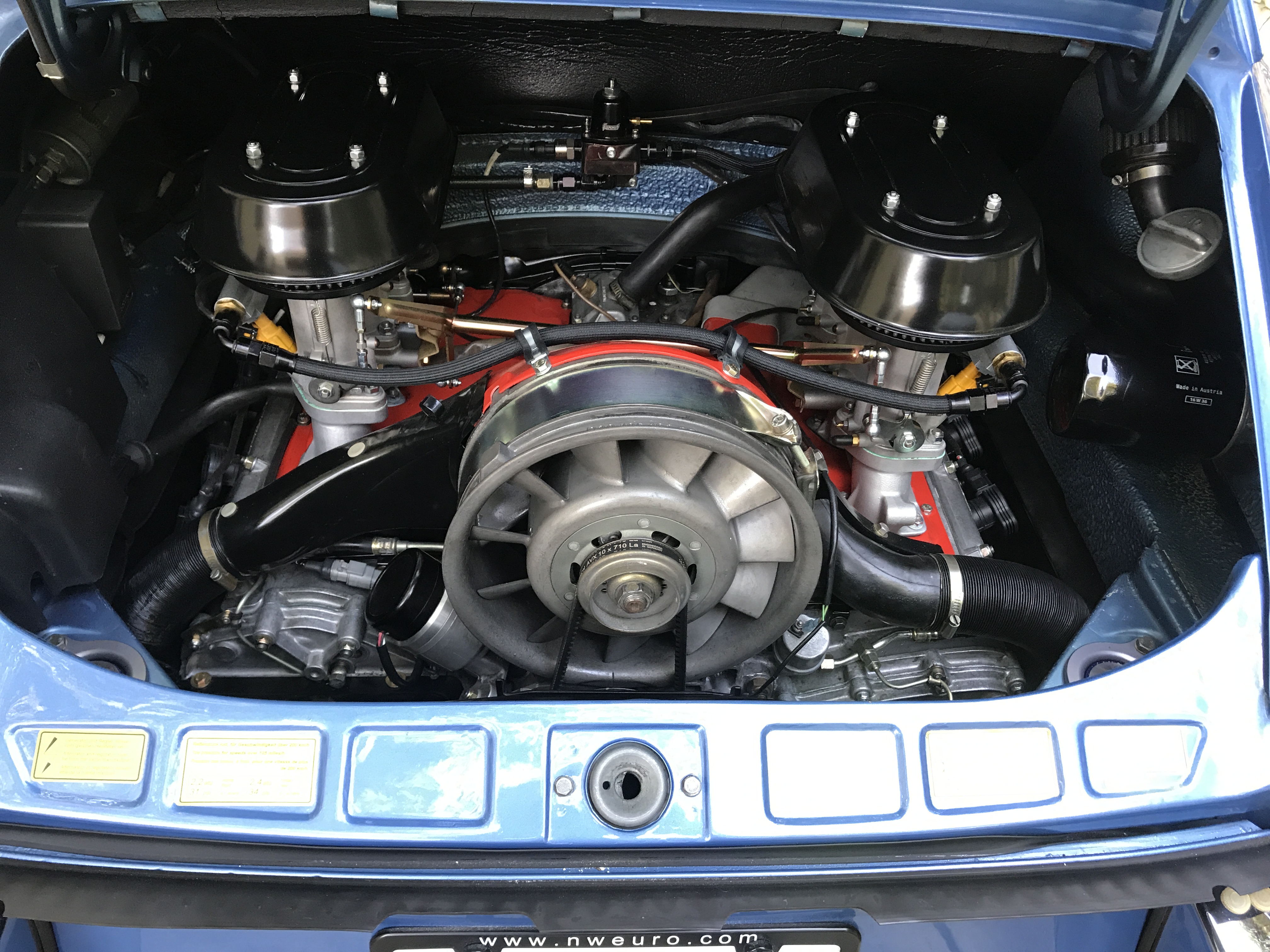

Forget all that CIS crap and make it look old school by converting to an EFI/ITB set up like I did on one of my early 911’s. The PMO ITB’s look just like carbs which is why I went that route.
