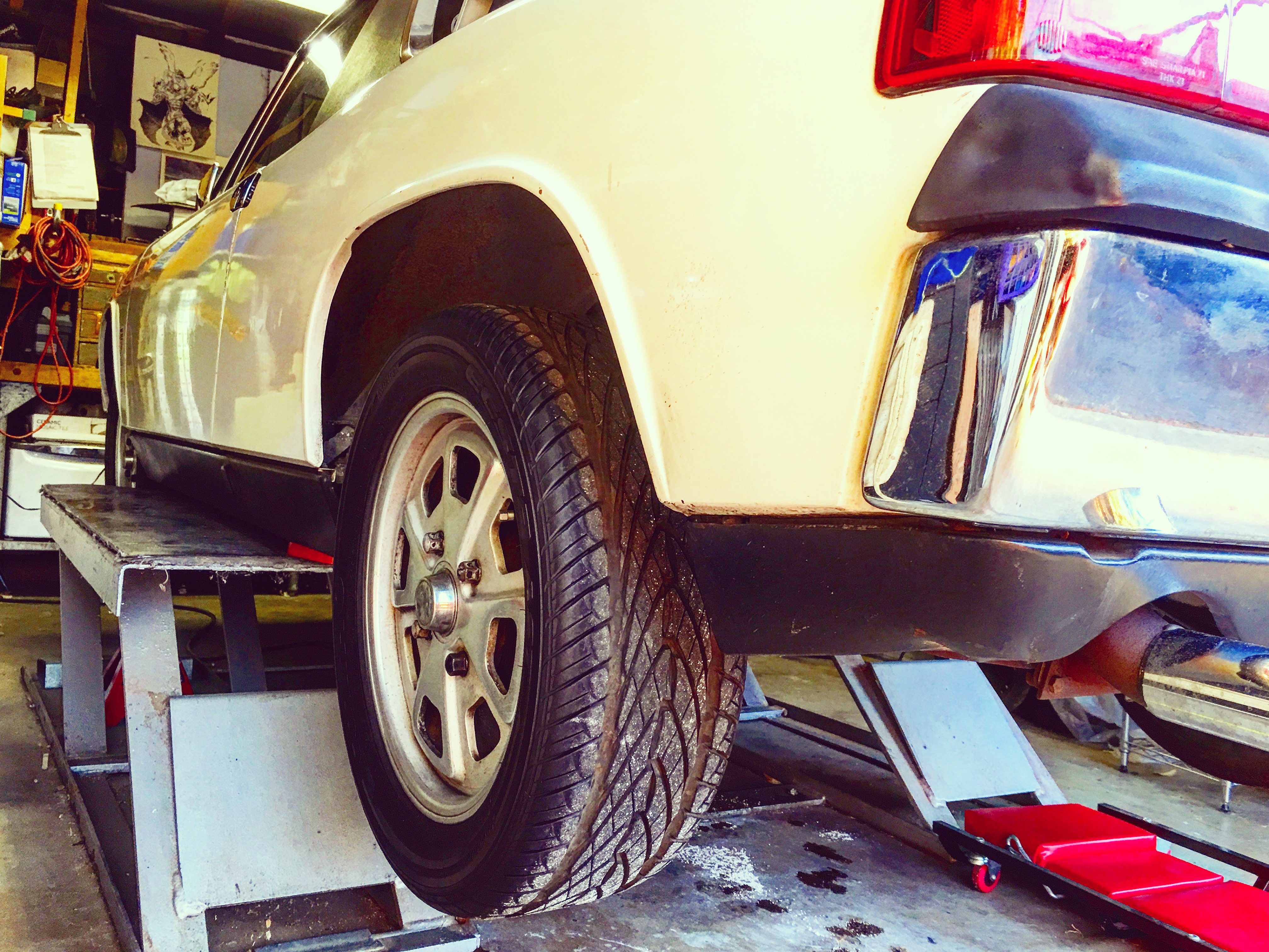

Attached Image I got this off of crags list its a tire chief has work out fine.
