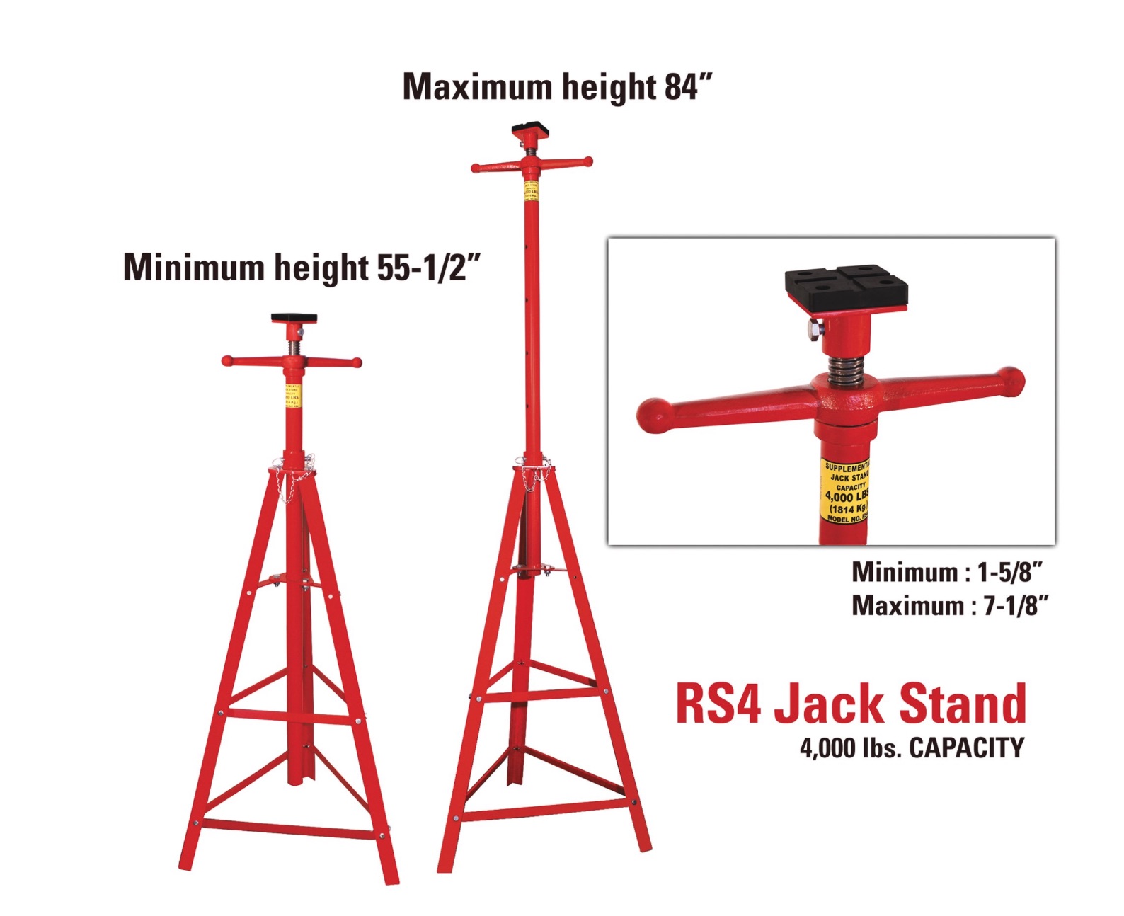

FWIW: It's apparently a little known fact that a third "leg" is recommended for 2 post lifts.
I use an older Rotary screw jack for extra stability when they're up high or if there's going to be some "tugging" on non-compliant nuts and bolts.(IMG:style_emoticons/default/wink.gif)
The Rotary RS4 is sold on Amazon for about $140. Well worth it for added insurance.
Also recommend HD rubber lift pads that are cut for seam welds. Easier on the chassis.
