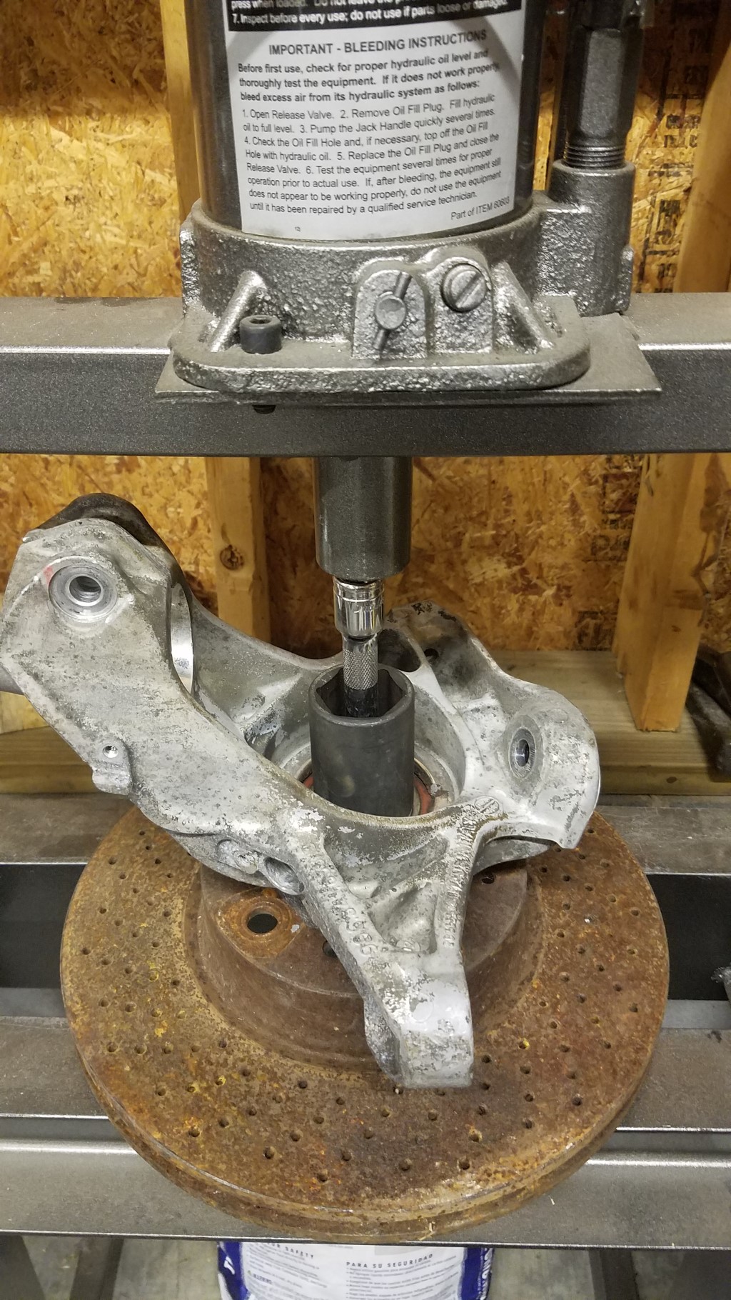

So I've been having some fun. I started breaking down the boxster suspension. Here's a pic pressing out the bearing. Those things were in there!

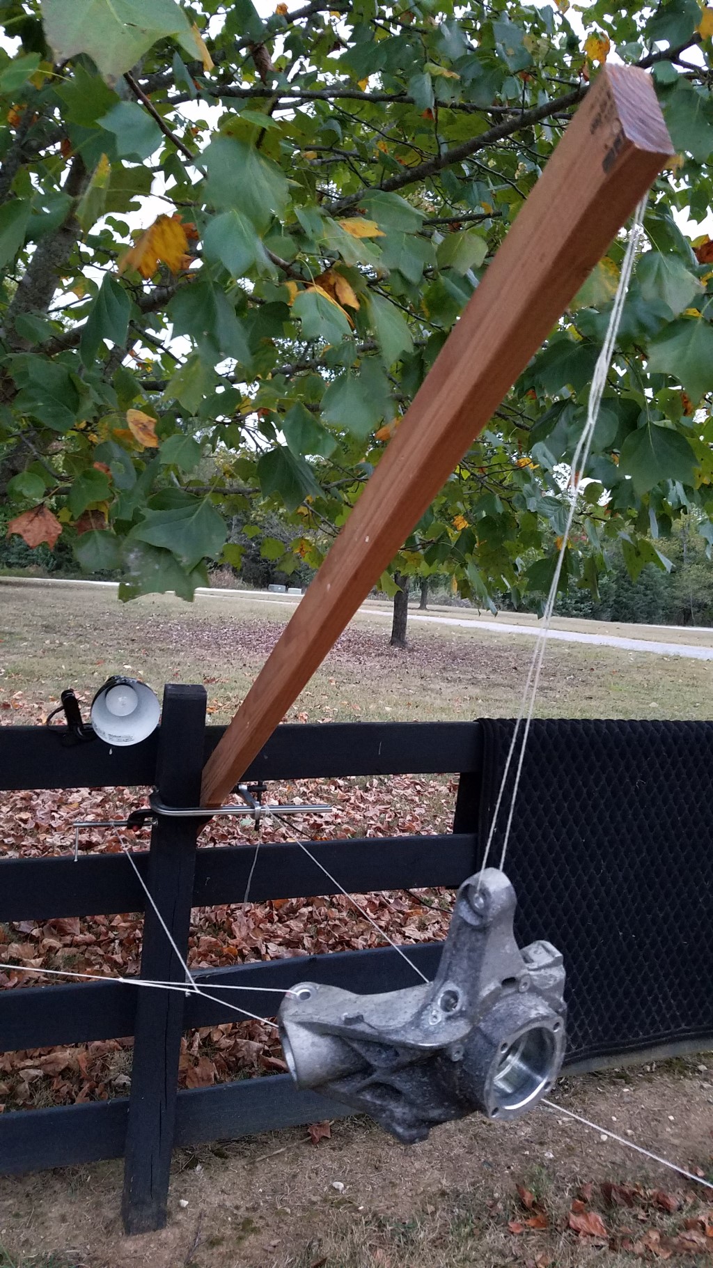

I was going to start attempting to model some of the important points in Solidworks and then remembered reading an article about photogrammetry and how it's possible to obtain 3D data from pictures. So I gave it a whirl and I am freaking mind blown. I used my samsung S7 camera (cell phone) on the auto settings and a really basic setup to suspend the knuckle from strings.
Here's the physical setup.
I took 219 picture at a multitude of angles. I did no editing of the pictures and uploaded them into RealityCapture. A few clicks later, about 10 minutes of processing time and NO cleanup this is what it generated.
Here's a video flipping the mesh around
https://www.youtube.com/watch?v=SJXa_tz24t4
i am beyond stoked! (IMG:style_emoticons/default/piratenanner.gif) This is more than good enough to cleanup and retain a reasonable accuracy for modeling purposes. I'm still learning how to cleanup the mesh and manage the file size. However, this took maybe 4 hours, including learning everything for the first time. I could likely repeat this process in less than an hour for a new part. The idea here is that this will vastly speed up my process to design a custom front dual A-arm suspension. What a time to be alive..
