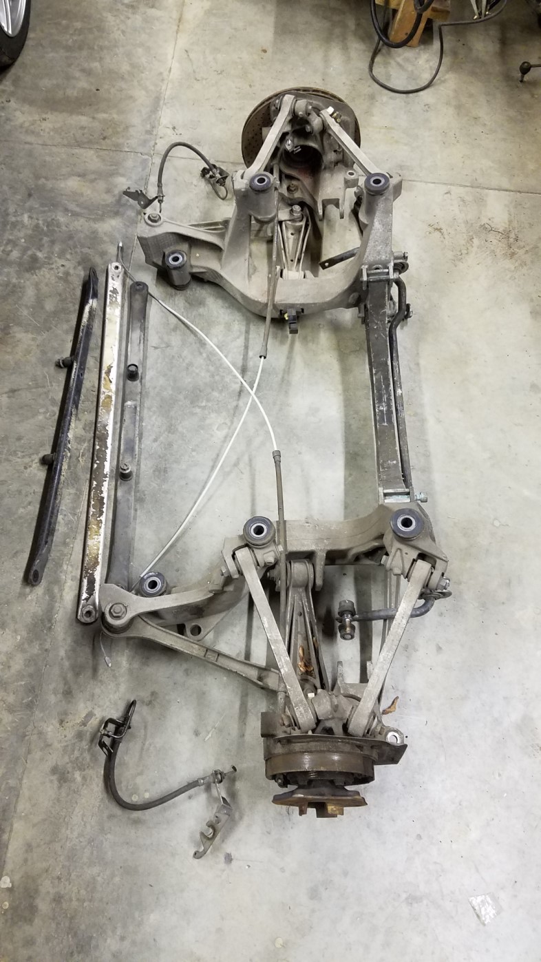

Dad and I drove to Tennessee yesterday and picked up the rear suspension out of a 996 C2. Made for about 12 hours of driving in one day but it was a killer deal. Here's what we brought home.
I took a few pictures of the mounting points on the 996 and was pondering the best way to mount it to the 914. The 996 has studs that stick down. I'm thinking the mounting points will be inboard of the 914 frame rails.

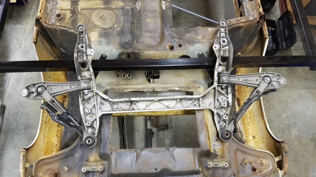

Along the same lines, I tossed the Boxster K-member on the bottom of the car to get an idea of where the mounting points fell.
