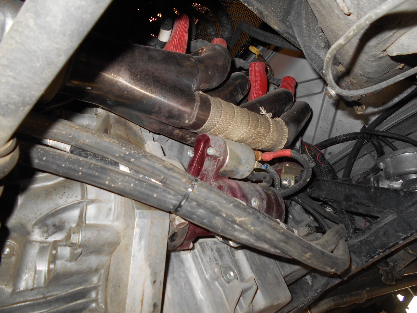

Lof8   Hey 6-speeders, anyone have photos of how they pen...   Aug 1 2024, 07:52 AM
tygaboy   Hey 6-speeders, anyone have photos of how they pe...   Aug 1 2024, 08:14 AM
technicalninja   [b]@[url=http://www.914world.com/bbs2/index.php...   Aug 1 2024, 08:23 AM
ClayPerrine   I ran one of mine through the speedo cable hole, a...   Aug 1 2024, 01:46 PM
