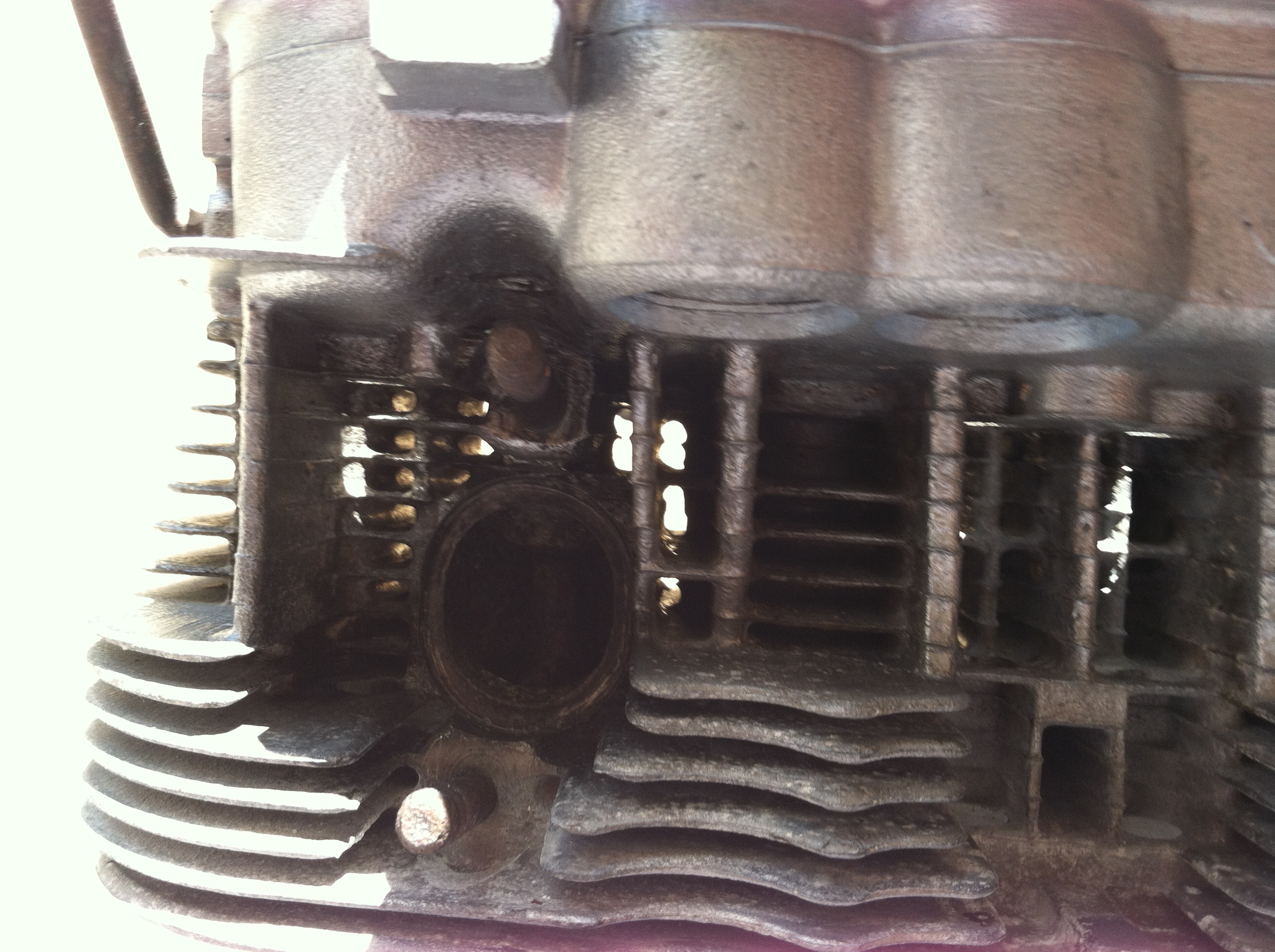

For any heads, check for excess casting flash in the cooling fins. My 2L heads had lots of flash with age, junk had accumulated in the cooling passages limiting air flow considerably.
Here's agter drilling out:
