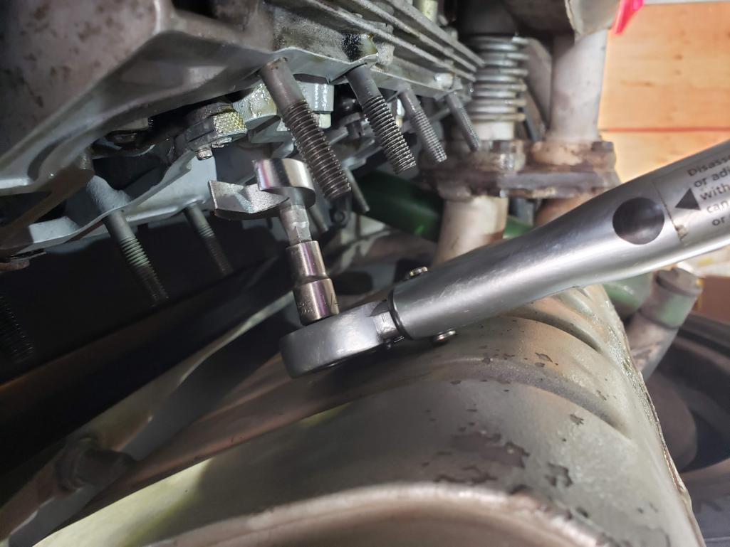

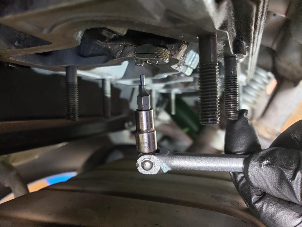

QUOTE(914dave @ Oct 11 2019, 04:16 AM) *
I have my set sitting on the shelf waiting for The next adjustment. I may actually be able to do the valves with the engine in.
For spaces where the T-handled wrench does not fit without removal of components (or dropping the engine), you can use a 1/4 drive to tighten the small cap screw and a standard torque wrench set to 10Nm to do the torquing with whatever extensions you need. I know that my '78SC is not a 914 set up, but here are some pics of me working around the CAT on the left exhaust bank.
